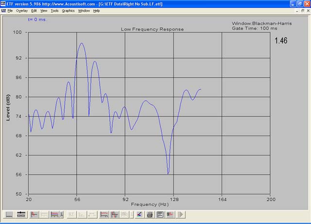

Has anyone measured the CS2 in-room low-frequency (f3) cutoff?
In my opinion, this would be a totally useless measurement.  For instance, tell me the f3 cutoff for this speaker:

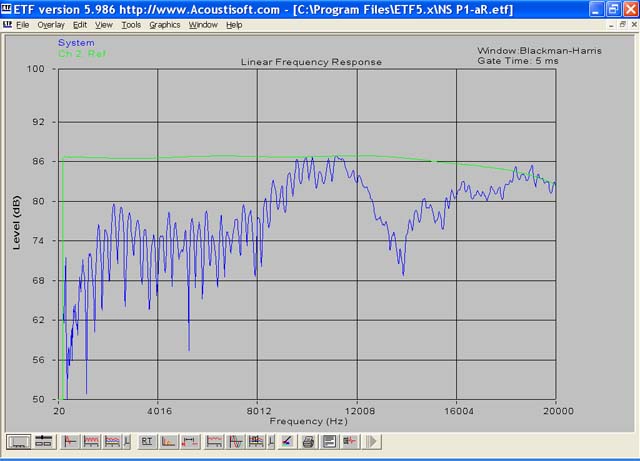

Here's the overall response (though the low frequency here should be ignored):
These are from a single VMPS RM40 operating in my HT room.  I can't remember how many bass traps I had at the time, though.
