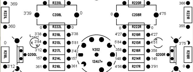

So, i changed 12AU7, both tubes are not brand new but i don't believe both are damaged,here are the results:
Voltages were measured on both sides of resistors, it's marked as OUTER (resistor lead nearer to edge of PCB) and INNER (resistor lead nearer to center of PCB), sorry if some terms are wrong in english, i must confess i'm Spanish
LEFT CHANNEL:
- R215: outer 3'75 - inner 5'78
- R217: outer 3'05 - inner 3'29
As you can see in PCB R218 is mounted vertically so there is no OUTER or INNER side, just UP and DOWN
- R218: up 0 - down 3'03
RIGHT CHANNEL:
- R215: outer 4'30 - inner 5'76
- R217: outer 3'65 - inner 4'23
- R218: up 3'73 - down 0
i also tested following resistors on both channels: R215, R216, R217, R218 and R219 and values are OK.
i found interesting that "R218L up" voltage is the same as "R218R down" and "R218L down" is near the same as "R218R up"
any suggestion will be welcome!
1) DC voltage at C106 respect to ground: 7'65
    DC voltage at R104 respect to ground: 7'55 (outer side), 3'89 (inner side)
2) AC voltage at C102 respect to ground: 3'82 (outer side), 3'75 (inner side)
3) at R215 i measure 5'91 VDC, Jim replied maybe changing some resistors i could increase voltage to 6'2 VDC
now it's 10'36pm here, so i'll check components from R215 to C209
Thanks for the patient!!!

Hello,
I think the heater, although a little bit lower, is fine unless you cannot measure anything at C205 with respect to ground.  My problem is that at R219/R217 junction, why are you measuring a very low dc voltage?  Looking at the schematic, one end of R219 (connected to C208) is about 150 Vdc while the other should be approximately more than 150 Vdc. if everything is working fine.
My hunch is that the problem is on the Q200 transistor for both channels.
regards,
Abe
