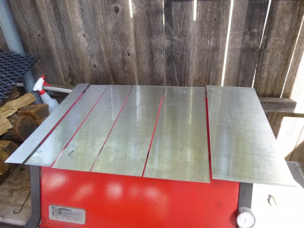

16G stainless steel is "B" to work with.
WireNut
Posts: 1957
Re: True Smokers
Reply #187 on:
20 Jun 2013, 10:12 pm »
Yes it is. Nice work tho. You must have bought those to size or had someone shear them to size for you. If you drilled those with a hand drill I know that was a bear. Looks like it will work
Every time I see that smoker I'm in awe
Keeps getting better and better
TrungT
Volunteer
Posts: 1918
Re: True Smokers
Reply #188 on:
20 Jun 2013, 10:28 pm »
Thanks
I had the metal shop sheared to size, then hand drill with running water to keep everything cool.
Took me 4 hrs to finished though.
I'm thinking to add another removable rack above the main one.

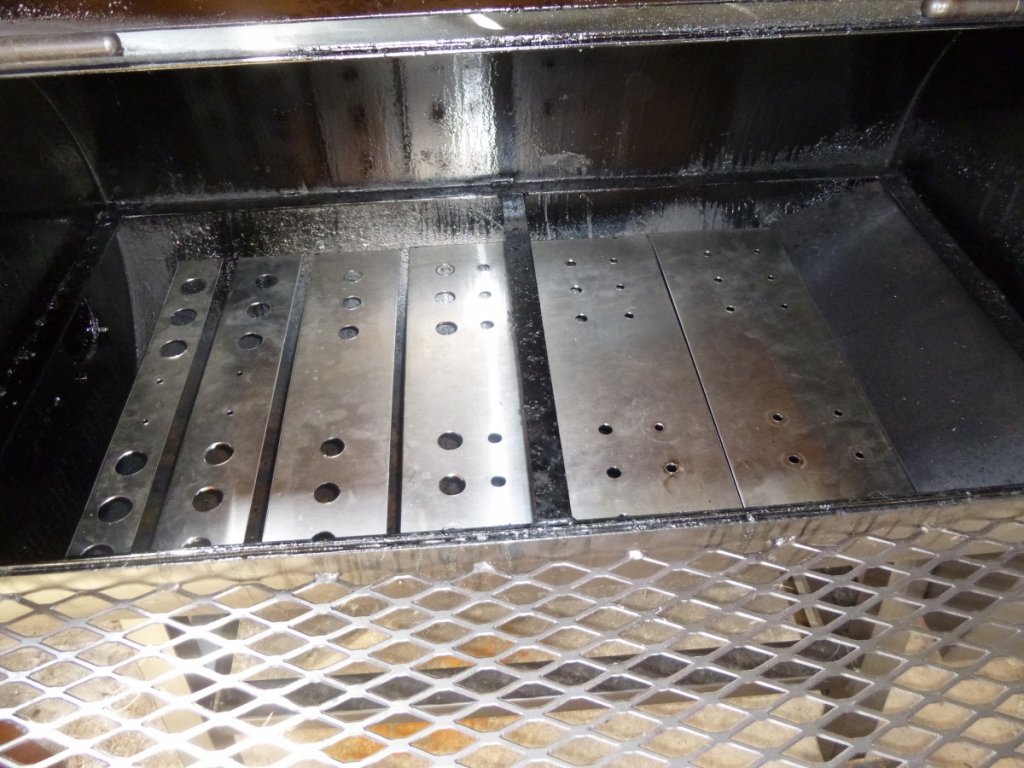

if you're going to do tuning plates they should not have holes in them, if it's a one piece plate then you use the holes. with tuning plates it's the space between plates that controls the heat dispersion.
Bob in St. Louis
Volunteer
Posts: 13270
"Introverted Basement Dwelling Troll"
Re: True Smokers
Reply #191 on:
21 Jun 2013, 02:42 am »
I wondered about the holes too.
I'd never seen that, but since my smoker doesn't support the use of tuning plates, the only thing I know about them is what I see the BBQ forums guys use when they post pictures of their smokers. To date, I've never seen holes in tuning plates.
Note: "Child-like optimism" starts here:
I guess it wouldn't hurt. Worst case, you've lost some of the tuning capability, as the heat is going to escape too soon and the left side of the smoker will be cooler than it should be. If you're not doing whole hog, I guess that would be alright. if you do two briskets, the right one will finish quicker.
TrungT
Volunteer
Posts: 1918
Re: True Smokers
Reply #192 on:
21 Jun 2013, 03:07 am »
Well .....
None tuning plates: just move the plates together
Easy to clean out.
This way, I do have more option.
