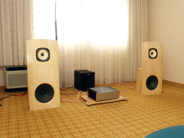

I've heard a couple of versions of Nelson Pass' open baffle designs at the Rocky Mountain Audio Show the last couple of years and his design had great impact. He used the Tone Tubby 10 inch bass driver (this year) and last year used a Seas driver.

How do you compare the Tone Tubby 10" bass driver with the Seas? These 2 drivers have very different characteristics, if possible can you describe them if you can remember thanks.
opnly bafld
The TTs were only going down to @70hz and they were using a $150 sub from 70hz down.
Lin
Thanks for the response, the TT drivers must sound pretty good otherwise Nelson Pass would not have used them. I am thniking of using them in a cabinet instead of OB. Even if I use them as OB I need a subwoofer or a sealed bass/ported 12" woofer cabinet.
JohnCZ
ttan98,
If I remember correctly, Nelson used the PM6A the last two years or so.  Last year when he used the Seas drivers they sounded very fast but a little lean.  Transients were very good and kept up with the Lowther.  It seemed as though his filter/crossover was a little steep or maybe a bit low with the Seas design. With the Tone Tubby there was more upper bass. The foundation was more substantial.  I liked the Seas and thought it was a good match with the Lowther.  The Tone Tubby was a substantial step up in bass.  It sounded more at home in an open baffle than the Seas did.  After hearing the Seas design I wanted to try and build an open baffle to see what I could do. Upon hearing the Tone Tubby version, I wanted to buy Nelsons speaker.
John

And there you go , John.  Tastes are different.  I liked the rig with the 2 tens better.  The Tone Tubby was good, but the 2x10 was much more to my liking. (were they Seas?)
I may agree that the TT matched in tone a little better with the Lowther, but the Seas sounded much cleaner to me.
Of course, there was a year between listening sessions, so take that with a grain of salt!
I suspect Sea sounds cleaner is because Seas has much lower distortion than TT, I think TT gives you more body to the sound. It is all a matter of taste as you say. I personally prefer the drivers that give me more body/rounder sound, compared to a leaner/cleaner sound from Seas.
opnly bafld
2007   Seas W26
2008  Tone Tubby and crappy sub
