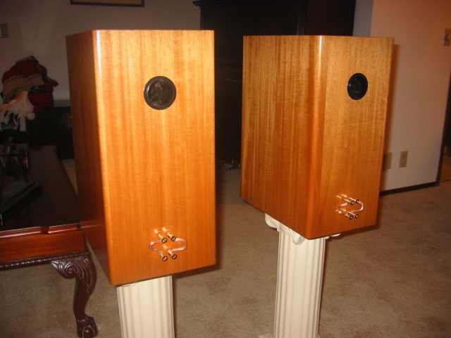

Which brings me to my question for you guys.  As I think I mentioned somewhere previously, I plan on doing external cross-overs.  I also have sufficient terminals to allow for bi-amping/wiring all the way through.  So, I have 12 sets of Danny's heavy brass speaker terminals.  I want to have the terminals popping straight from the back of the box(es).  Preferably, no plastic spacers or plugs showing.  Like this from Darren's gallery:

Danny Richie
Binding post
« Reply #24 on: 14 Nov 2003, 07:00 pm »
You can always counter sink the whole thing.
Just drill your holes for the post and insert them on the plastic holder.
Then draw around it with a pencil or something.
Then use a 1/4" straight cut bit on your router to cut it out by hand.
If it is not perfect that is okay. You can always use some wood fill or Bondo and some sanding to get it all straightened out.
When you veneer over it no one will know what's underneath.
Also keep in mind that you are drilling through 1.5" of MDF.
You will need to use one of these bits (see below) on the inside of the cabinet so that you can get the nuts on the other side of the binding post and have room to turn them.
Or you can use a hole cut saw to cut a large hole in the inner layer before it is assembled.
