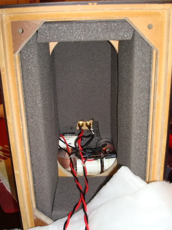

Hank
  • Posts: 1206
Re: New kit, Neo-2X
« Reply #92 on: 15 Jul 2008, 03:41 am »
Okay, I'm going to try to post a photo
YES!!!!!!!!!!!!!!!  Finally!!

Hank

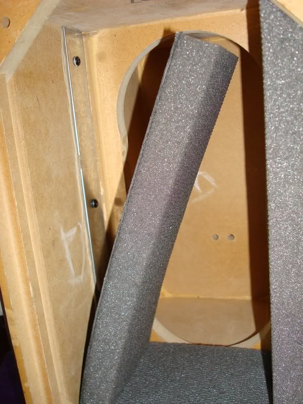

« Reply #94 on: 15 Jul 2008, 03:47 am »
And another, showing one of the steel reinforcing straps I installed (construction adhesive and screws):

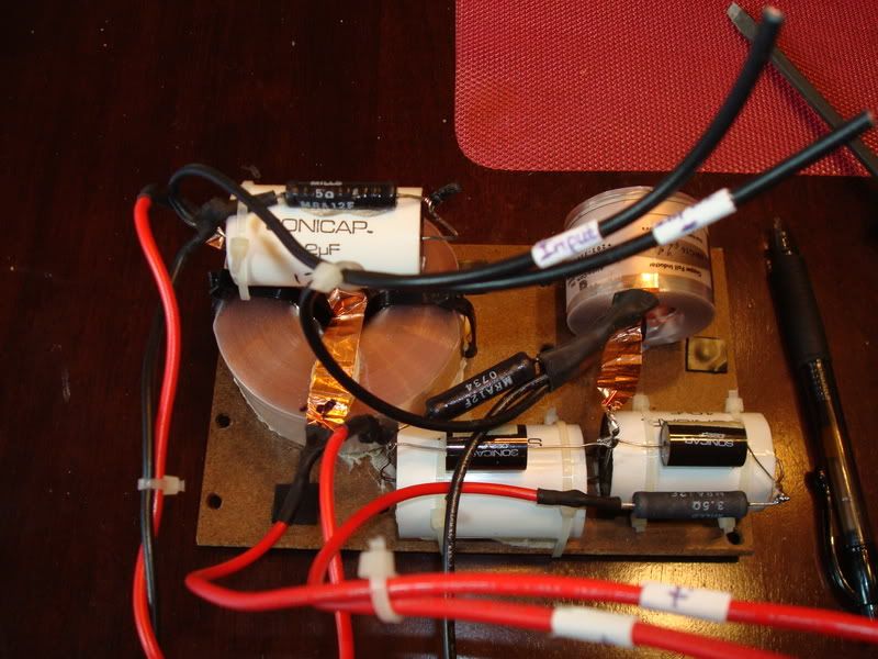

« Reply #95 on: 15 Jul 2008, 03:50 am »
And, the crossover:

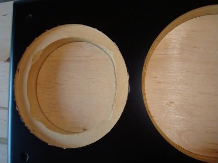

Somebody stop me!
The screw-up:
Hank
  • Posts: 1206
Re: New kit, Neo-2X
« Reply #97 on: 15 Jul 2008, 03:55 am »
Okay, using the Contact clear vinyl to protect the paint.  Thd circular marks on this baffle are not scratches, but adhesive:

Hank
  • Posts: 1206
Re: New kit, Neo-2X
« Reply #99 on: 15 Jul 2008, 03:58 am »
I did on the one that messed up.  The Jasper jig caught it in several places, balling it up, leaving adhesive all over and then the paint was scratched.  I think all the jig hole edges caught the edges of the blue painter's tape.  Normally our 3M tape works great, but in this case, the Contact shelf liner worked.
