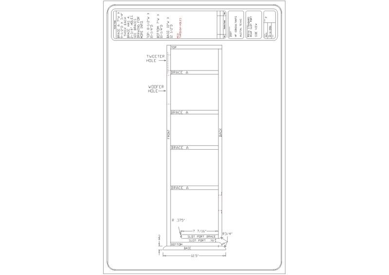

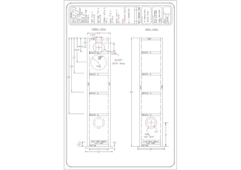

The tower cabinets I designed for Al's RAV-6 speakers should be good for Danny's optimim low extension Neo-2X.
I got a program to convert .dwg files to .jpg, so I'll try to post.

Starting this weekend (hoping my speaker parts arrive today) (Danny?) I'll actually be building Hanks Floor standing Rav6 Converted to Neo-2Xs. I'm basically using the plans that Hank posted. and then slapped the speaker spacing from Danny's Neo-2X plans (the tweeter center is a little higher and the woofer is a little lower). I'm also moving the port to the front. Stay tuned to see how they come out.

Hi David - I assembled Lou's and burned them in for a couple of days (good excuse for enjoying them aa), and I don't have plans to build a pair of my RAV-6 tower version.  As you probably know, the RAV-6's use Danny's same woofer and Al's custom Arum Cantus ribbon tweeter, and Danny designed the crossover, so the performance should be just about equal - difference being mainly the higher cost and fragility of the A.C. ribbon tweeter.
Yes, I'd like to get to your place sometime and give a listen - maybe Golden Ears Scott could join us.
Regarding switching the RAV-6 slot port to the front, you don't need to unless your tower placement dictates you have to place them closer to the wall than about a foot and a half.
Fred:  I have construction step photos if you'd like to look at them.  Also, to simplify construction, you could use a tube port, although Al talked me into the slot - he swears the slot "sounds" better.  Have fun making MDF dust :thumb:
