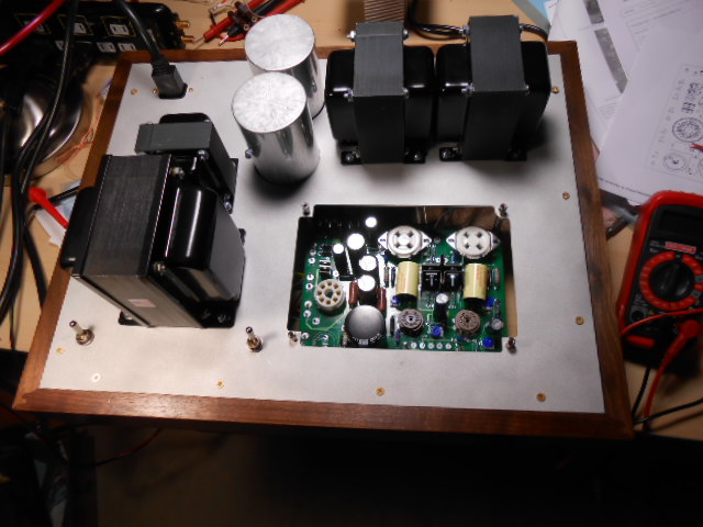

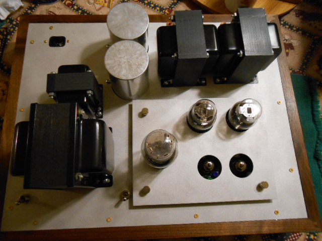

  Hello to all,  I have followed this thread along with another cap test and chose AudioCap Theta in the coupling position of DIY Tubelab SE built for 45 tubes. I have two questions, see below
I understand Jon does not like the 5842 tube,  the TSE uses the 5842 with a CCS and voltage is adjustable with a pot in this design. I have gone to extremes to have a cool running amp and power transformer.  Even though I was advised against using the FT-1 200v coupling caps they work and since I have a thermistor  in the H.V. supply the voltage never goes above the 150 volts that I have the 5842 running at.
1) Should I be concerned running the FT-1's at 150v given that they are 200v caps.  Startup voltage swing is not a problem, see above.
When I first installed the non burned in FT-1's for a couple of days I was very very happy.  None of the rich and full bottom end of the Theta's was gone but the top end opened up and I noticed three major differences. Bass definition and timing was improved.  Spacial images were rock solid steady and any effects in the recording process were immediately indefinable. There was a slight grain heard but not bad in any way. I have started running the amp full time the last few days and I imagine 150-170 hours have passed.
The grain is gone.  The lowest bass impact and fullness has almost returned.  If I had not heard the difference I might well say that this is perfect.  Not really complaining about the sound just wishing for more low end weight.  I want my cake and eat it too kinda thing.
2) My AudioCap Theta's are .47 uF and the FT-1's are .022uF 200V,  Should I buy some lower value FT-1's 2200pF 600v caps.  Will a lower value FT-1's allow more of the Theata's through?      Or do I just need to do more burn in?   Just noticed some 5600 pf 600v on FleaBay.
Thanks for any input.
Walt

wroman214
 I thought of one other question.  I installed the FT-1s below the circuit board and soldered to the exposed leads oth the Theta's.  I taped the body of the FT-1's with paper tape to avoid accidental arcing across other leads from below.  It is possible I do not have the FT-1's mounted in the same direction (after taped can read).   I say this because during the ugly part of the brake in the sound almost seemed phasey if you know what I mean.  I am going to check this but before I do I thought those of you that have an oscilloscope or cap tester and used to using the FT-1's you may give a preferred orientation based on the writing on the cap.
Thanks
