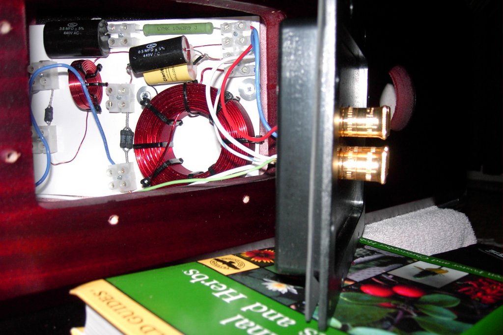

Its got me wondering about pulling out the Clarity Cap px5u2j250 (5uf?)bypassed by an black coloured"AC" brand , 440 v .5mf(probably low cost china caps) and an AC 3.5uf for the tweeter.As Im just about  to put in two brand new hi-vi research d6.8s I got from Solen into my 12 year old now mothballed Totem Forests I noticed the crossover has these caps just bolted into it with steels screws on plastic terminals. It really looks like it would be a cinch to bolt in some er lets say Clarity MRs capacitors like in the more higher end "Signature" Improved version of the Totem Forests are now using .Looking at this I see you like that pricey beeswax copper foil paper Jupiter the most. Im presuming its the "copper" ,thats the secret to its sound quality Im guessing. I hope you have tried listening to other copper foil ones about of interest like the Audio Note copper polypropylenes from Parts Connextion at half the cost. Ever heard those? Im starting to get really tempted . Whadda you say?
