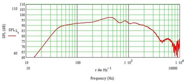

The baffle is 45cm x 112cm. Woofer at 63cm and Tweeter 91cm. I forgot what Tweeter freq. is but it's 3.3uF parralel with 2.2uF + L .56mH  (2nd order).

Here are two simulations of your Alpha15 baffle. 1st as is is now:
2nd with a second Alpha lower crossed LP at 300 Hz , 12dB/octave:
No EQ in any case.
/Erling

Looks like those FR simulation graphs were created with Quarter-Wave software, created by AC'er Martin King.  :thumb:

Wow that's a good program (MJK I suppose)?  It seems that my eq can do the same as the additional Alpha with no eq but they both roll off rather quickly below 40Hz which is Fs. I wonder now if they can be pushed towards high 20s when a pair is used  aa

Of course it's MJK's MathCad models, the best software we have for these simulations. MJK himself has published a lot of Alpha simus so I don't think he will mind.
