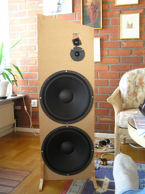

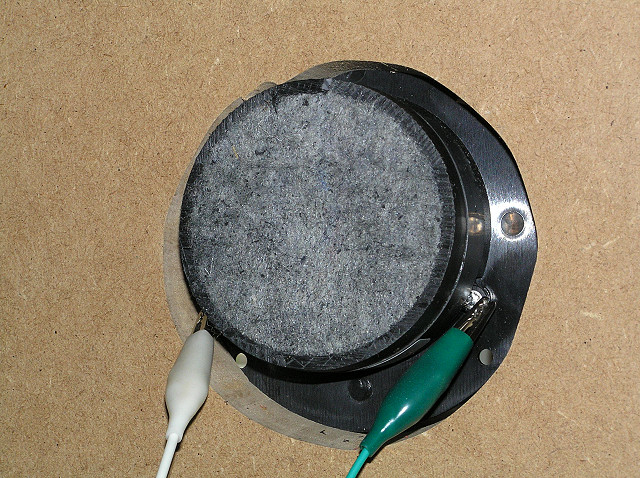

In the mean time I have been experimenting with my 2 Alphas and the Vifa D27TG35-06 going active with DCX2496. I received two Vifas after a long wait and recognized that they could be put in my MS-100CHQ cut outs in the MJAO baffle. I also performed the tweak suggested by Ric and cut off the back of the Vifa's dual chamber.
Well, what to say. This speaker as now presented 2 Alphas and the Vifa D27TG35-06 crossed at 950 Hz active is so far the best OB I have experienced.
The Alphas bass/middle may be a bit too dark in direct comparison, with for instance the MJAO, but still very good and certainly benefitting from the active drive. On the whole they put out a performance second to very few in direct comparison. And I have a hint how to perhaps overcome this weakness of a bit darkness. The Vifa however is extremely good. You can't really imagine how precise and detailed this tweeter presents itself, it is amazing. The whole speaker benifits from this and altogether you get a sound and image quite superb. The active driving of course is really responsible for this. You may be astonished how little energy really is transmitted by the tweeter at 950 Hz and above and how big an impact it really does when active. No EQ was applied to the tweeter. My concern now, will the waveguide really 'improve' the Vifas ? No other of the proposed bass tweaks were performed. The link to Ric's 'Modding' page is: http://www.tweakaudio.com/EVS-2/Modding_the_Emerald_Physics_spe.html .
There are some pictures accompaning these statements: First the baffle with the Vifas put in place:
then the tweaked Vifa tweeter:

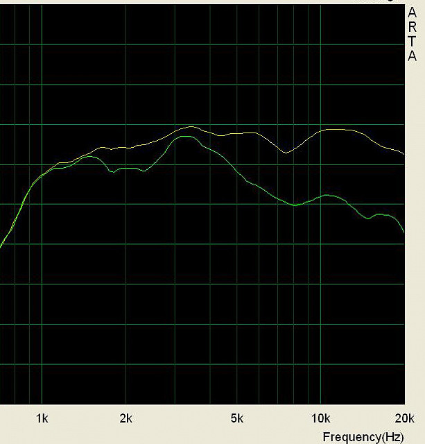

and last a measurement of the tweeter frequency response at 50 cm in front and in back, the higer output is from the front, 1 KHz crossover, 10 dB division:

The Alphas are a tiny bit on the dark side so I don't think that felt on the inside of the chassis is really called for. Damping the outside might still be a good idea. The Vifas might very well be as near perfection as you can come, at least for the price, when tweaked for dipole performance as suggested by Ric Schultz. The forward/backward power relationship is perfect.

Can you describe the process you used to cut off the back of the tweeter?
How far back from the end did you cut?  What tool did you use to cut?

I used a hacksaw to cut off the last millimeters from the plastic back.

You must time align all drivers.  The Behringer can do this very simply....once your system is in pretty high tweaksville, you should be able to hear the smallest amount of time alignment distance allowed in the Behringer.....delaying it forward or backwards...it should be easy to hear.  The Vifa tweet with the back cut off is not a true dipole.  The felt blocks most sound from coming out the rear.  It does have some sound coming out the rear but nothing like what is coming out the front.  Please time align....you can do this physically or electrically but it makes a huge difference.....in all speakers.

But quite revealing I think. All-thogether with active EQ you can really make the Alphas very authoritative speakers. Certainly very listenable. With this combo I do find the whole sound to be a bit on the dark side even though Vifas was not treated any. Crossover at 937 Hz 48 db/oct. The back output, as shown by my measurements, is not insignificant. But I have tried DCX2496 alignment and you are right there, I can really hear when things are right.
