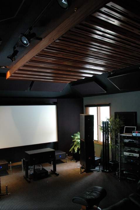

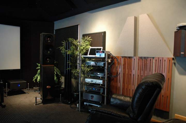

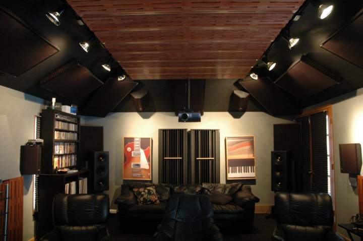

Well, the Hedback Design room acoustic makeover is completed.  We installed the large ceiling diffusor/trap yesterday and the sound of the room is transformational...a qualitative shift in everything...tonality, image specificity, detail, naturalness, soundstage depth.  It's as if I told the room to "settle down and let me listen" and a whole new world opened up.  Hell, it will probably force me to relook speaker positioning, etc...except my 90 minute listening session last night was sooo good that I'm not sure i wanna fix what ain't broken.
Thanks to Jeff Hedback (designer/acoustic engineer), my local craftsman extraordinaire Doug Carpenter (yes, that's his real last name :) ) and to my wife and family for putting up with this.
All told, the major changes were:
* front corner traps, floor to ceiling, custom made.  Allowed me to repurpose the Realtrap Mondo corners to the back sloped area.
* a 400 lb tuned membrane "floating wall" on the front wall, behind the screen assembly, which brought about amazing soundstage and balance (fewer nulls, etc) improvements by itself
* side wall diffusors and tetrahedral treatments that open up the room and improve even surround high rez imaging.
* the piece de resistance, a large ceiling cloud, hanging from acoustical clips, made up of wood diffusors and 4 inches of bass trapping foam insulation.  (There is light roping installed but it shows up very slightly....no big deal, the roping set me back $12.).  The energy held up in that ceiling area was quite high, caused mostly by my sloped ceiling design when we built the house.  it was a good idea at the time!  :)
All of the Realtrap products and GIK art panels continue to do their jobs (in many cases re-positioned), and work in tandem with the Hedback Design custom built foundation.
(Pictures have darkening window treatments recessed to show natural light, but I never listen/watch that way.  Left wall area is also cleared of RFZ trap for same reason, to let light in).

(Jeff) Hedback Designs did an incredible job of modeling my room, guiding me through recording some analysis sweeps, etc and explaining the deliverables in both very technical and dumb'd down ted mode.  Moreover, he produced a detailed, 3D google sketchup set of documents that Doug worked off of without a hitch.  Jeff never visited the site (yet :) ) but had huge hunches that he never waivered from, even when I panicked several times during the project.  Net/net, Jeff knows his sh$% !!!  And the value prop is quite amazing.
Oh, and thanks also go to Art Smuck here at AC for turning me onto Jeff once i saw and heard about his own room transformation here.  I contacted Art asap and we spoke several times (and finally met at RMAF).  Thanks Art!   :thumb:

The diffusors are technically known as HdAcoustics’ HAR slats (Helmholtz Angled Reflectors).  They are a repeating set of four angled diffusors, built out of poplar, stained and poly'd.  The side wall diffusors have a backing that is less bass trap and more just a sturdy frame that was covered in the same GOM material as the "sails" above them.  The ceiling system is indeed both a huge bass trap, with 3 inches of air separating the ceiling with the topside of the cloud, 4 inches of acoustic material, and then several sets of HDAcoustics HAR slats running east-west.  The size, materials and HAR pattern were designed specifically for my room, but Jeff would use the same concept to tackle similar issues elsewhere.

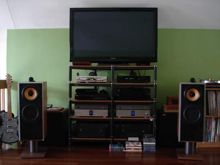

Geeze, I'm almost embarrassed to show mine but...

Nothing to be embarrassed at ALL there... your room looks very comfy.... & sound is what matters.. and I'm sure yours sounds more than fine.. nice Godin by the way.. :thumb:
