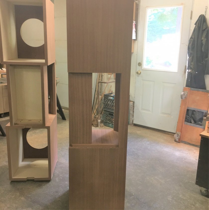

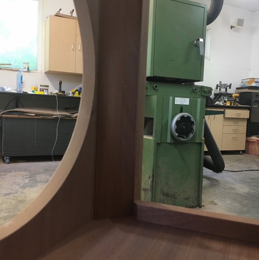

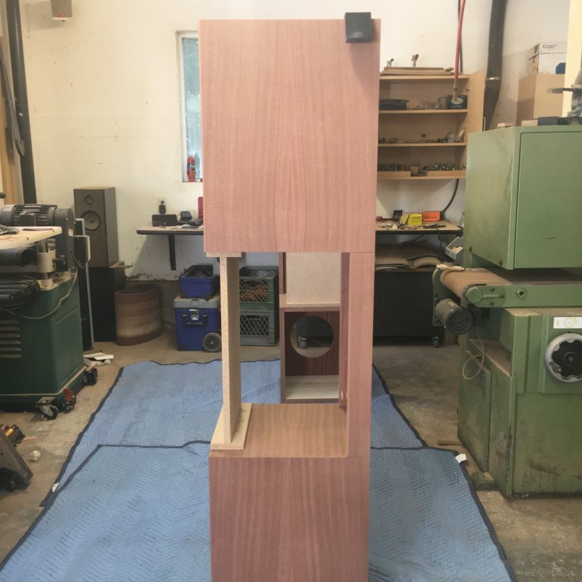

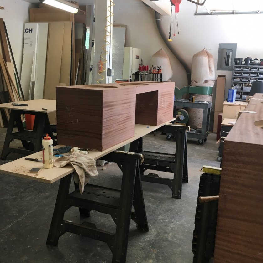

These could have been built modularly but wouldn't have quite had the same seamless look. The bass boxes, front baffle and short baffle returns were all glued up as one unit. The plate amp/crossover box was a separate unit and was slid in and screwed at the top and bottom. It provides most of the rigidity of the structure. I put some angle block reinforcement at the baffle returns to strengthen them up a bit. Here's a couple pics to clarify.
