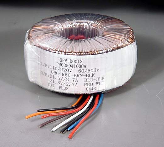

« Reply #155 on: 2 Sep 2008, 02:54 pm »
I'm still trying to get my brain around this circuit and it's components.
Would something like this work?
http://www.apexjr.com/images/AdireToroid.JPG
If it will work, can I use just one for both left and right woofers since it has dual secondaries or would I have to have one for each channel?
Martin.
Graham Maynard
  • Posts: 274
    • Class-A//AB
Re: Passive LF boost circuit.
« Reply #156 on: 2 Sep 2008, 08:09 pm »
Hi Martin,
Yes that transformer with an 8 ohm loudspeaker would be suitable to test whether you will like the circuit or not.
You will need one transformer per channel.
It is possible to separately drive dual voice coils with L and R output, so that a single woofer produces mono bass.
However, bass is recorded in stereo too, and mono-ing it will not only remove any differential energisation aspects of LF reproduction, but also reduce the level of LF experienced within the playback room.
(Indeed, mono-ing the LF is a good way of reducing room induced LF feedback for vinyl playback.)
Cheers ........ Graham.
