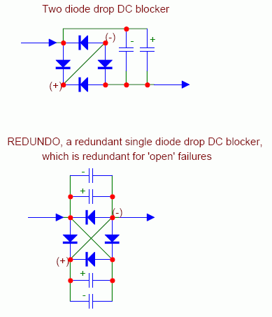

A little mundane perhaps but, Friday I built a couple of dc blockers (a 1 diode drop and a 2) and tested them with a stereo bridged chip amp with twin toroids.  I used a space heater to get the transformers buzzing enough to be heard from the listening position and spliced the blockers, in turn, into a PC.  The one diode blocker wasn't all that effective, though it did cut the noise down to where I could only hear it from 2-3 feet away.  The double diode blocker worked quite well, I had to basically put my ear to the chassis to hear the transformers, though removing the lid made them audible again.
I built two more of the double diode blockers and inserted them prior to the Felix conditions in my monoblock  amps and the original in the preamp.  I'll probably disassemble the single diode and build another double, putting it and a 17a Felix in a "hot box" to feed the entire system.
