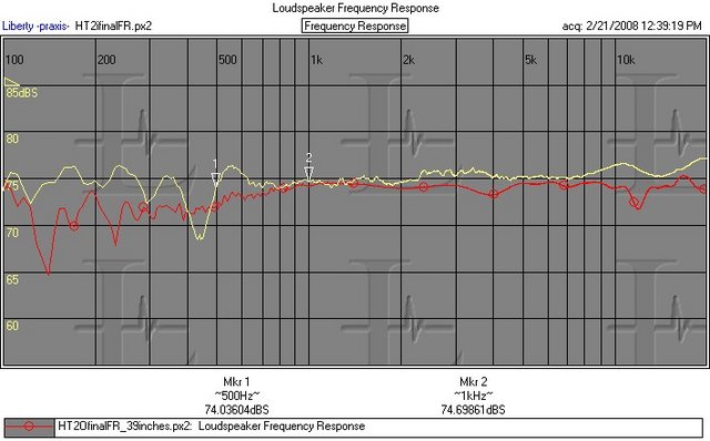

Hey Al, what is the other line representing in this graph?  Is it the other tweeter?

This was a test aa
See if anyone would ask about the FR shown.
What they were was during crossover designs for both we took the plot for both the frequency response of the HT2i plus the HT2O (new OW4 dome model) and over layed them.
These were plots during development and not the finished designs.
