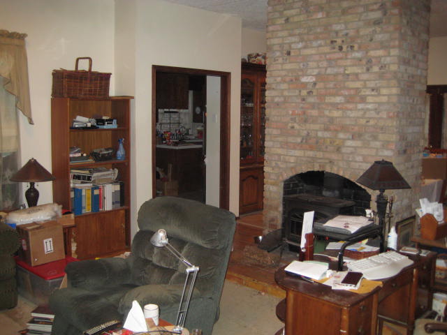

The room is hard to describe.  This area of my home is semi-open architecture, with the living room separated from the dining room by a free standing fire place making the effective room length around 60 feet.  The right side wall is a row of windows leading to the sunroom; the left is a hallway that acts as a foyer also connecting several bedrooms.  The ceilings are all 10’.
