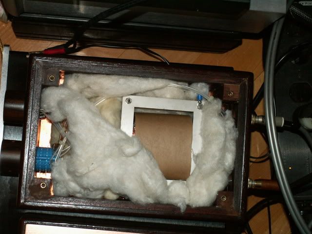

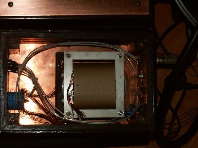

In the weekend I managed to :
1. Use one power strip for CD transport, DAC and power amplifier ;
2. Put in wool to fill the cavity of the wood chassis.
Here is my findings :
1. Changing to one power strip and ground the ground tip of Ref C-core to the Earth of the power strip does not improve the hum and its harmonics. However I double the wire thickness connecting to the chassis of the power amp( I was using a telfon multi-stranded silver plated wire and  now I use two twisted together) has some improvement. Now I can hardly hear the harmonics of the hum at my listening place. I can still hear the noise if I am from the speaker by 5cm but this is no more a big concern to me.
2. Filling the cavity with wool -- I tested with the input of Ref C-core opened and the microphonic effect is still very prominent. But since this is the best I can do, I closed the cover, reconnected to the DAC and do listening test again. I found the bass to be more solid ( previously the bass seems to be lighter comparing to without Ref C-core). The texture is also more realistic and the silky nature retains there. Oh now I love the Ref C-core even more.
I am thinking adding a sand base for a next step tweak.
I attached two pictures showing before and after adding wool.

AFAIK, these are the very first internal pics of the new C-core TVC. Very interesting.
I'm not clear on what you mean here. Are you saying that the wool made the bass more solid, and improved the texture of the music?
Has anyone else tried this wool tweak on their TVC? If so, what were your results?
Thanks.
