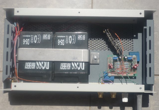

Hi Tim,
Can't figure out how to post pics directly but here are some shots of my "Paris".
http://www.audiocircle.com/index.php?action=gallery;area=browse;album=487&pos=18
That's the first of 4 ... scroll through.  The actrual PCB is dwarfed by the 2 6v gel cells!  :lol:
