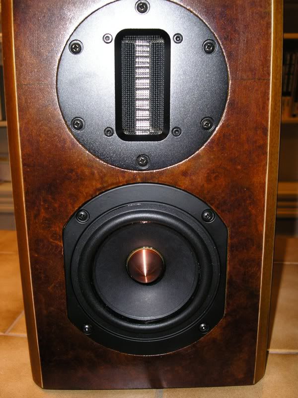

What a wonderful review, but even more, what an incredible build! Excellent work  :thumb: I encourage you to build more and share, your build quality is  :drool:

Lovely finish!

 Very nice looking speakers. Job well done. You mention regrets about not going with the full SoniCap crossovers. Any thoughts of doing a third pair. If so, I would recommend going with the full SoniCap crossover and stepping up the bypass caps to the Platinum Teflon units. This would open up a whole new world :green:
 Again, very nice build on teh speakers.
