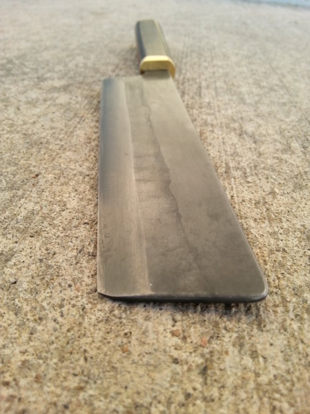

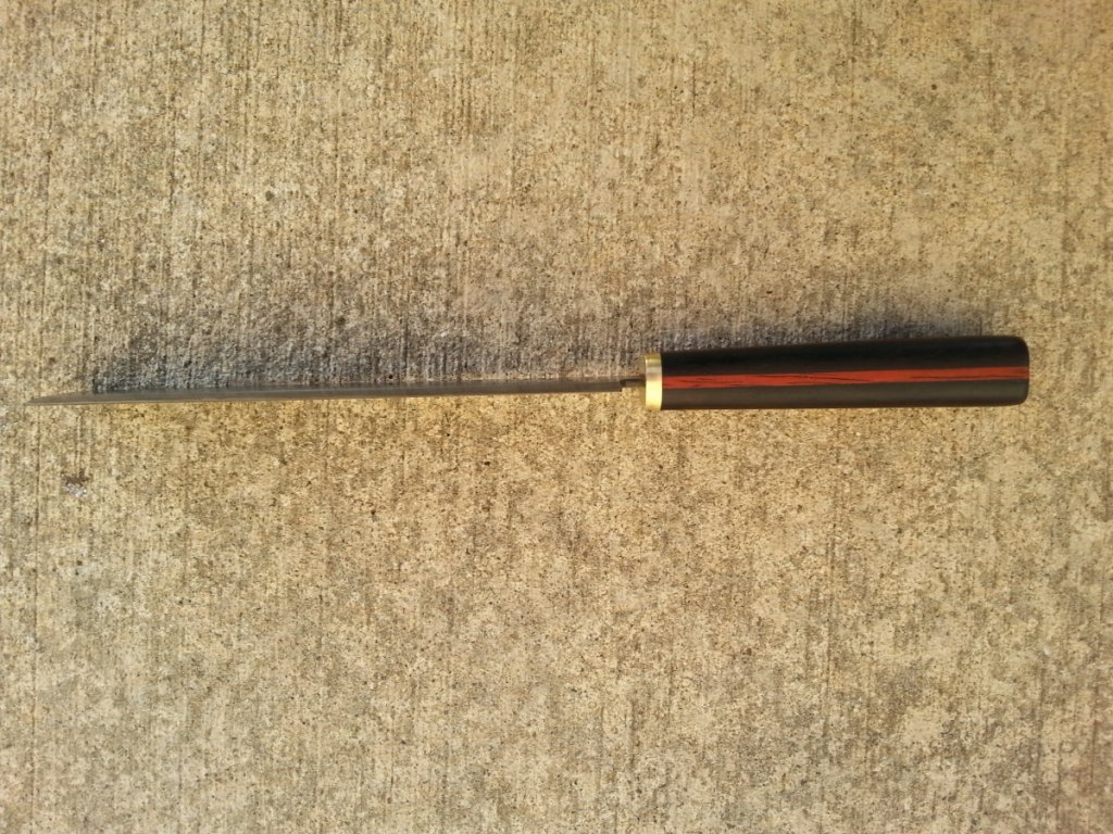

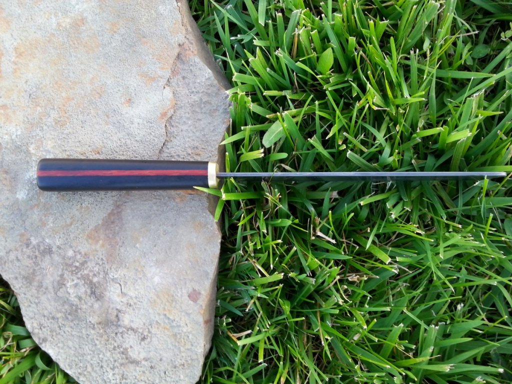

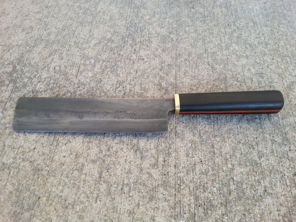

This is a Nakiri I made and sold. Made of 01 tool steel, quenched in water, the hamon line came out very well.

Picture are often deceiving, but it looks thick for a Nakiri, more like a cleaver.  My Nakiri is probably my favorite knife to use.  Do you use a pinch grip on yours?

It's 3/32" thick 01 tool steel.
sometimes, when I need to make a accurate/fine cut, but the rest of the time I use the standard grip.
My knives are very hard (62/63 Rockwell Hardness), but they are easy to sharpen, using a steel rod. making a dozen strokes, about 13/15 degrees. Making a flag on the edge, then I micro bevel at 45 degrees. I always micro bevel.
(modified: let me stress, my knives are very hard on the edge, but soft enough to bend where the hamon line stops. And hard as 62/63 RC from the hamon to the cutting edge.)

That's a much nicer looking knife than my nakiri, and with that hardness it should take a screaming edge.

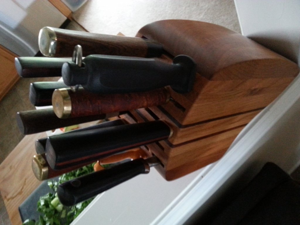

Pic of my arsenal..
