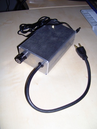

I have succeed installing the walwart stock PS in the Felix PS box (two in one) to eliminate the receptacle and plug with wires. My Felix (based on Gary model's) sounds very very nice. However, IMO I replaced the Vishay 1.0mF/440V at main out (before walwart) with a Sonicap GenI 1.0mF/1200V. My musics have extremely improved I have never believed.
My next Felix project is a dual CMC in one box with a dual receptacles (better quality one I have in hand like FIM or Hubbell...). Will post pictures later on. Good luck.
Tan

Hi Mike,
Does your Felix and stock switghing PS run hot or warm? I built mine in an aluminum box (from Fry's electronics) and it is very cool. My Newava's modded SB3 is sounding much more details and clean deep punchy bass with a very sweet midrange (with my tube gears).  :thumb: :banana piano:
« Last Edit: 17 Feb 2008, 08:50 pm by tanchiro58 »

Does your Felix and stock switching PS run hot or warm?
Tan,
My Felix / switching power supply also runs very cool.  It's not even warm to the touch.

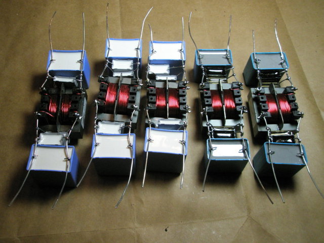

Buddy :thumb:
GBB
Re: Felix meets the Squeezebox
« Reply #58 on: 17 Feb 2008, 11:54 pm »
First I want to take my hat off for Gary/GBB and Paul/Occam for bringing this excellent and affordable project to everyone here.
Buddy,
You're welcome.  I think your suggestion of trying the Felix out on DVD players and other equipment having switching supplies is great.  It will definitely have a big impact on many items like that.
I've noticed a lot of discussion on the other Felix thread about building circuit boards to make it easier to build a Felix.  While I applaud that effort, I personally don't think it's needed.  You can easily wire these things up point to point.  Here are a couple of pictures to make the point.  I bought a few more of the Coilcraft CMCs as seen here:
I solder on a few inches of 18 gauge bus wire to each connection of the CMC and then hook the caps up to the bus wire as shown here.
I then hot glue this to the bottom of the enclosure and wire it up to the fuse and then wire up the input and output power connections.  Its really not necessary to have a circuit board for something like this.  The Serpac case that someone mentioned seem like a good fit.  I bought some of the type 153 at the local Fry's for this round.
----Gary
