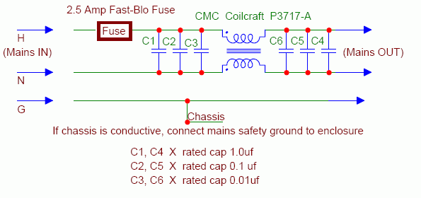

First of all, let me say how much I appreciate the interest people have shown in this thread and the very nice private messages that I've gotten regarding this project.  That said, I'm going to have to request that people not ask me for a blow by blow description of how one can build one's own version.
I've been talking to Occam / Paul about the many requests we've been getting for more details on how to build the Felix.  Quite a few folks have asked for pictures of the inside of the Felix to aid in the construction.
After bouncing this around, we've decided to politely decline and not post any pictures.  Our reasoning is that if someone needs anything beyond a schematic to build it, then they shouldn't be attempting it. The Felix involves potentially very harmful AC voltages. If one isn't comfortable building it with just the schematic, then it's an indication that you may be in over your head and shouldn't try to build it.
If you go back to the original Felix thread, the reason that Paul didn't provide specific detailed plans was based upon his experience with the prior Felicia project. On that project, he answered specific build questions, both on thread and in PM, and it ended up taking hundreds of hours of his time.  It is unreasonable to expect such hand holding from Paul or me.
So all we can offer you is the schematic which has been redrawn to shown exactly what I built.
If you can't build a Felix from the schematic alone, you shouldn't be taking on this project.
All the best.

Thanks Gary,
I'm going to order the parts today. Your schematic is very clear and unless one has absolutely no inclination to learn about the details of electronic construction, the build should be no problem. It would be great if this filter would render optional the need for a very expensive Squeezebox power supply for quite and clear sound quality.
-Roy

Gary,
Am one of the guilty persons who have either sent PM's or posts to Occam about the Felix and Felicia.
Any feedback or suggestions is always greatly appreciated.
You people willingly provide the DIY circle with so much information, which as you stated takes up a whole lot of your personal time.
You probably know this already, but the original Felix used .47uf x rates caps on the C1 and C4 positions; with the typical 1/5 - 1/20 prior value bypass caps.
It also used the 2.3amp J.W. Miller 8109 CMC.
Anyone interested in this can view the original plans in the Felix Project thread.
In lieu of the "free samples" currently being offered, the J.W. Miller CMC's work extremely well and are fairly cheap; in relation to what the JR filters use.

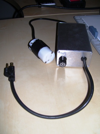

This is a picture of my Felix:
Thanks to JoshK, Occam and Gary to post this possibility of easy-to-built project. I am enjoying my sweet musics. Just for now testing with CI VDC-SB+Modded SB3. Will test with switch PS and DIY Linear PS.
Best regards,
Tan

This is a picture of my Felix . . .
Just for now testing with CI VDC-SB+Modded SB3. Will test with switch PS and DIY PS.
Tan,
Nice work and thanks for sharing the picture of your latest creation.
I look forward to hearing the results of your listening tests.
