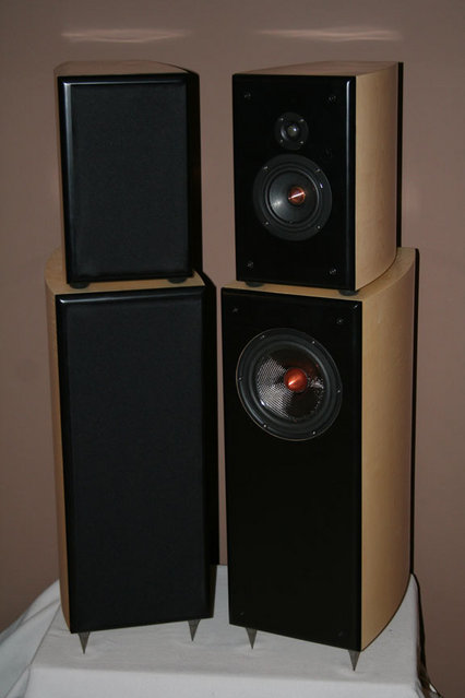

Using a  small soft dome tweeter
There will be a B series coming, MT,MTM plus a 3way with both the MT as well as the MTM.
All will be designed for the Parts Express curved cabinets for the DIY.
Plus all parts (less the drivers) can be purchased direct (with a list we provide) from Parts Express .This will make a cost friendly series of kits using the FR125S driver plus the SDX7 woofer in the 3way matched with a Hi-Vi tweeter.
Out first will be the TMW design using the .25cft cabinet for the MT sealed and the 1cft ported with the SDX7 tuned in the cabinet to 27hz.
Drivers we will provide for $299.99 for the TMW and crossover parts you can order direct from Parts Express ,starting from $135.00 including the Dayton Bypass caps as well.
More information as we get them finished.With the TMW done first it will be ready to release in a few days.
OK cost break down for this new 3 way
$182.99 Dayton caps with film and foil bypass caps with 15g inductors on the mid and tweeter and a 16g Iron Core on the woofer
2-2" flared ports you must cut to length
4-Binding posts ( 1 pair for each of the cabinets all these holes are pre drilled)
2-Speaker spikes tapered cone
8-rubber feet to isolate the MT cabinet from the lower cabinet of vibrations
40-screws
1-screw driver bit
$299.99 2-SDX7 XBL^2 woofers 2-FR125S XBL^2 midwoofers 2-dome tweeters direct from us
$35.79 PE foam and a roll of 16g wire
4- sheets of acoustic foam to line the TM cabinet as well as the woofer cabinet
1-50ft roll of speaker wire
$135.85 .25cft 2 curved cabinets (must cut driver holes)
2-.25cft cabinets available in Cherry,Maple and Black
$259.54 1cft 2 curved cabinets (must cut driver holes) $129.77 each
2-1cft cabinets available in Cherry,Maple, and Black
Total $914.16 for all the parts plus shipping.
Shipping on the drivers $42.00
Shipping direct from PE on all the parts.Watch as they have FREE Shipping from time to time.
Over all a 3way design for less than $1000.00 and you put in the labour for cutting the baffles, assembling the crossovers and assembly
We can provide all the package as a kit delivered to your door or we will provide the drivers and parts list and you order your own parts selecting your own brand of capacitors and inductors.
Or complete
$1399.00 plus shipping
in one of the finish options above
« Last Edit: 18 Jan 2008, 06:03 pm by RAW »

Updated with a few photos.

What tweeter is that?
Is the FR125S the new one with the more open frame?
Is the FR125S Enabl'd?
And is that price ($299) for a complete stereo pair?  Or should we double that to have a pair of speakers?
Thanks
Thanks
Hi-Vi T20-8 is the tweeter
Yes the FR125S new open frame (better venting around the spyder)
No the FR125S is not Enabl'd but for an addition charge we can have them done
The price of $299.99 is for the drivers ONLY all other parts you can source from PE with the cabinets.
Really in one weekend you can complete all the cutting of the baffles for the driver holes, assemble the crossovers and install the parts.
Last the port can be rear ported or front ported your choice.
