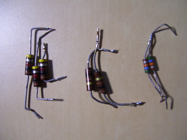

I have rolled the 6N1P tubes in my Apollo preamp with the Amperex 7308s. The sound does not buzzing like the RCA 6922s but it is very weak even though I turned up the volume. You told me to increase the value of the resistors to more than the existing 1K at the B+ voltage at 47mF and 200mF. Would you please let me know the exact value of those resistors? Thanks in advance.

Add 100R resistors to the grid. With the 6N1P is not needed but some tubes require them. Hence we started putting them just in case people start to tube rolled. You would need 2 pcs, 1 for each tube
On the resistors at the 47uf and 200uF, you would need to change all the resistors to 2K, you would need 3 pcs
And change the cathode resistor to 100ohm too, works out well, this is pin 3. You would need 2 pcs

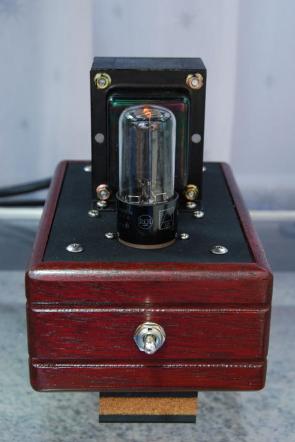

Check out the new deck on my Apollo. Some black coarse material that I'm unable to identify.

Nick,
Are the resistors at the grids (2x100R) and cathode resistors at pin3 (2x100R) the same? How many watts on resistors (1 watt or 2 watt?) do I need to have? The more watts the better? I heard that Allen Bradley resistors have too much noise because of the high percentage (5-10%) whereas Riken and/or Tantalum have less noise and more musical even though they are more expensive, is that true? How many resistors do I need in total to be able to roll 6922s and 7308s? Thanks in advance.

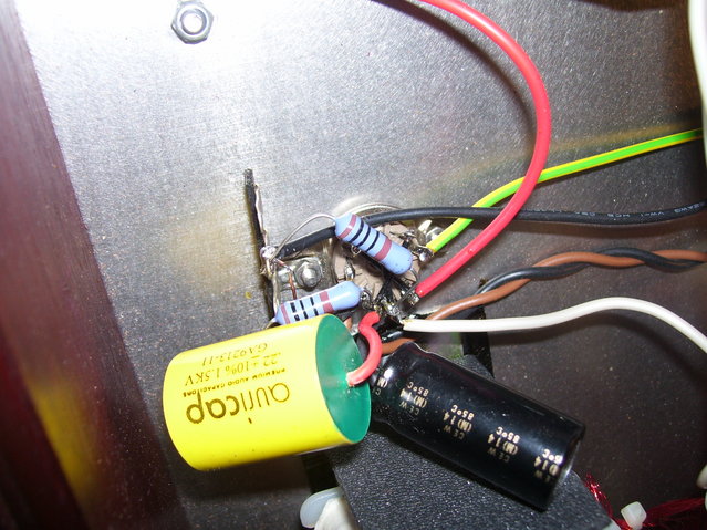

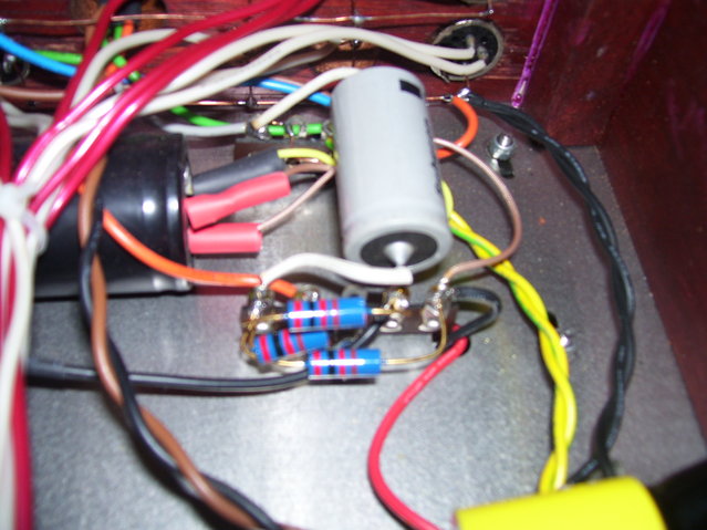

I got confused with the replacement of the grids and cathodes of the tubes if I want to roll 6922s. Which pin do I need to solder the extra 100R for 6922? You said pin 3 resistor should be replaced with 100R which is already there. From pin 2 there is a 2 Ohm resistor. So where do I need to ADD a resistor 100R for grid? Thanks in advance.
Riken 2K 1W at B+ voltage
Tantalums 100R at pin2 and pin3/ I am not sure where the grid is belong to which pin?
Stock Allen Bradley replaced

Tan in the pictures, you can see a white copper wire coming from the volume pot. that is the 7n wire and the other channel is red wire
What you do is insert a 100R resistor in series with this wire going into the grid which is pin 2 and pin7. Note we join them together.
This is done to prevent oscillation in the 6922 series which is not apparent in the 6n1p i am using
On the high noise this is preference. The high noise results due to the construction and not the percentage. Also the noise value depends on whom makes the resistors
I would stick to tantalum or rikens for our products as it would sound good together
Again to prevent the buzzing or microphonics just insert the 100R resistor as above to avoid this problem
Thats not black hold pad is it?  Now you've got me thinking...
Nick,
In another words, I just take out the connection from pin2 to pin7 and replace with the Tantalum 100R resistor then solder the white wire to pin2. Is this what you tell me to do? Thanks again for a quick response and help.

I did insert 100Rs (one for each channel) to the white and red wires in series to pin2 and still have buzzing or microphonics which is very annoying when I volume up all the way on my amp. Note I am using RCA 6922s gold pin made in Germany. Do you have another way to prevent this problem? Thanks in advance.
