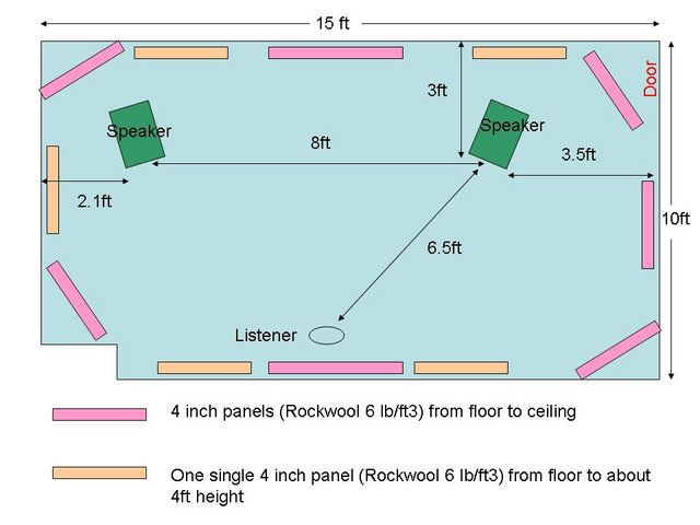

Strange enough...I'm glad that I'm not the only one. My previous room is about 10x15, conventional wisdom said  I should place the speaker along the short wall so I can sit farther from the speakers. I tried that and didn't like the sound - too much room interaction which pollute the sound, and the speakers are too close together so the soundtage was rather congested.
So I turned 90 degee and place the speakers along the long wall, about 8ft apart, and I sat only 6ft away. This near-field listening is truely an eye-opening experience. I'm hearing nothing but the purest signals from my speakers. There's nothing between me and the singer (vocal), as if she is just inches away, if I close my eye I felt like I can just extend my hand and touch her. When I first started it, I still had that little "inner guilt" that I was being stupid to defy conventional wisdom. But over-time I have grown to trust my ears, and I have come to learn that there are people out there who did the same and enjoy it. :thumb:
See my previous room layout below:
It would be nice if that room was another foot or two deeper, but that's the way to do it. :thumb:  I've been preaching that for years.  Electronics upstream, especially amplifiers make a big difference in terms of how close the sound is.  Most people if not all when they go to a live performance want the best seats possible.  If sitting in the back row at a concert doesn't cut it, why set up your system as such?
