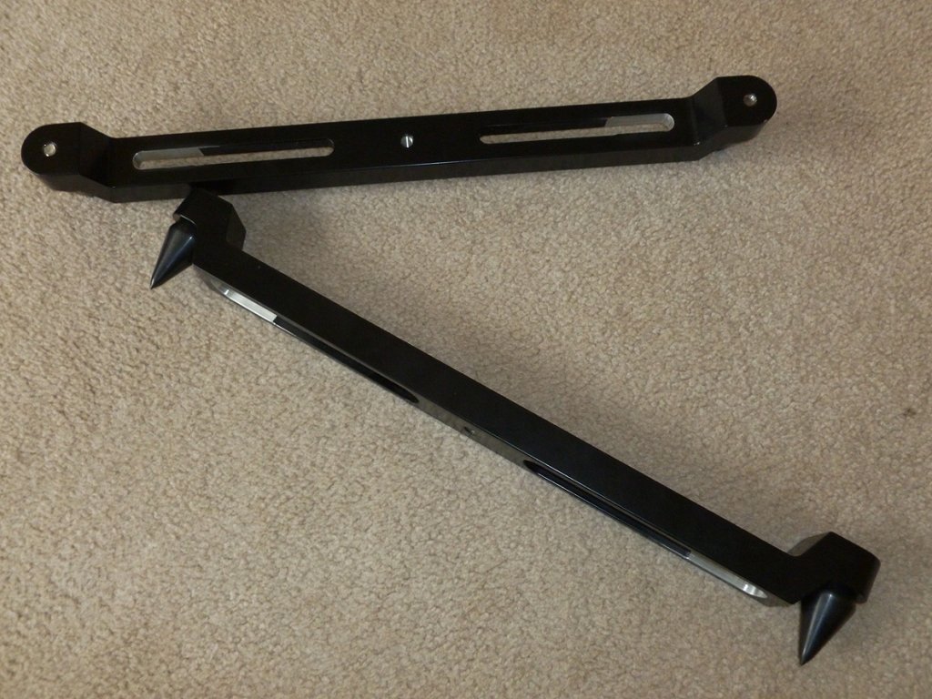

John Casler, I'd like to ask you a few questions about the RM40's bass plate if I may?
I have some universal speaker stands that I designed and had machined a few years ago and I have my own special cones/points. See pic below.
I know Brian did not recommend stands or points for the RM40's. Nevertheless, I''d like to see what sonic improvement (or differences) I might attain.
Can you confirm whether or not the bass of the RM40 is made of 1" thick MDF?
If I attached my low-profile speaker stands to the RM40's base plate by drilling four 1/2" through-bores in each bass plate and then using 1/2" socket head bolts, nuts, large washers, etc. do you think the base plate at the fastener locations can easily handle the stress of 240 lbs.? Each bar would have 2 bolts fastened to the base plate. The real question is, let's say I mount these stands to the base plate, one toward the front and the other toward the rear, 2 bolts per bar with washers and tightly fastened. If I walk these behemoth's of a speaker into position, would you guess the stress at the washers during this time might possibly tear away or crack the MDF?
My last question is, the black vertical slats (1 in back and 2 sides with open transmission line front) that the base plats mount to. Do those 3 slats go all the way up to the speaker tops as a type of structural beam. Or are these slats just a few inches tall?
Much appreciated,
Last Edit: 13 May 2015, 04:30 am by stehno

Those bases have 4 long screws in them, so you can remove base to get the passive radiator. Here is picture with base off. Good luck. ZAK
stehno
Posts: 70
Re: SET UP GUIDES for VMPS SPEAKERS
Reply #28 on:
13 May 2015, 02:12 am »
Thanks, Zak. Not quite on topic but you shed some light on quality of materials and construction in this region.
Based on your picture, I think my universal stands are out of the question as they would most likely induce severe stress points either at the base where the stands would connect or at the base where they mount via the 4 long screws to the MDF sides.
I think if I really really want to get this hefty speaker on my points, I would need to machine some custom aluminum base plates and screw them at the MDF panel ends about 1" apart just to ensure any stress is distributed as much as possible through the MDF.
Appreciate the info.
