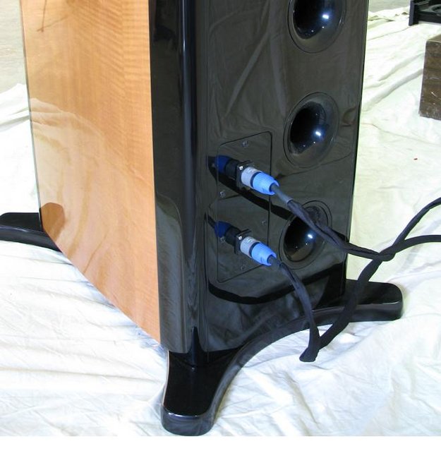

Mo bigga, mo betta...
The first of many pair.....
A number of interesting developments have happened since we started this project. More details and pics to follow.

Just saw this pop up, WOW DGO, beautiful finish on those speakers!! :o

It's easy to see why GR and RAW endorse your efforts.  Beautiful work! :thumb:

Here are a few preliminary teaser specifications
 Frequency Extension. 16Hz in-room response potential
Sensitivity: 91 dB 1W/1M
 Crossover frequency: 850Hz
 Impedance: 4 ohm - 8 ohm depending on Bass Management setting
 Crossover topology: Proprietary
 Crossover design: Custom outboard enclosure with single channel umbilical cords for the upper and lower frequencies with Speak-On connection. Bi-Wire/Bi-Amp 'able
 Wiring: "Continuous Cast Copper"
 Bass Management Control: User adjustable 11 position Bass Management System to accommodate for room acoustics. This is accomplished via external "on-the-fly" switching.
 Minimum power: 50 watts
 Recommended power: 200-500 watts
 Cabinetry: 1.5" minimum wall thickness with sculptured side panels, EXtensive internal bracing for EACH driver. Rear ported x12
 Height nearly 7 ft with base and footers
 Weight 350 lbs. each channel.
 Appearance: Work of Art
 Performance: Mind Blowing
Credits
Speaker and crossover design: Danny Richie - GR Research
Custom Cabinetry: Denny Muratovic - Custom Concepts
Crossover assembly and component voicing: Bill Baker - Response Audio

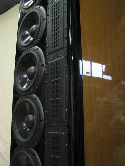

Here a lil' detail shot of the front baffle....
Can you guess what the weather was like that day?  :lol:

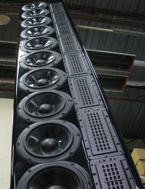

Another shot.
