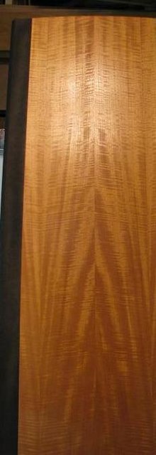

We had 2 highly figured Anegre veneer 4' x8' sheets done up for these ( just to give an idea on cost, the veneer was $200 per sheet). The color is custom as well. It's analine dye. We made a color chart, photographed it in sunlight, and indoors, and emailed it to the customer. We blended 2 colors from that chart 50/50, and also did some mild glazing in the clearcoats to give it some more warmth and softness.
Here's the veneered enclosure showing the heavy figure after 2 coats of vinyl sealer.
The finish is a true piano finish. After spraying somewhere between 15 to 18 coats of clear, we let the finish cure as long as we can. Then it's wet sanded with 1200, 1500, 2000, 2500 grit wet/dry sandpaper. Then it's 4 stages of polishing with a high speed buffer. The final stage is a glaze. We don't wax them, as it would be a serious liability. These weigh over 300 lbs a piece, and it would be very difficult to get a proper grip to install and stand them up.
