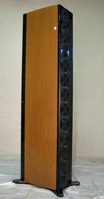

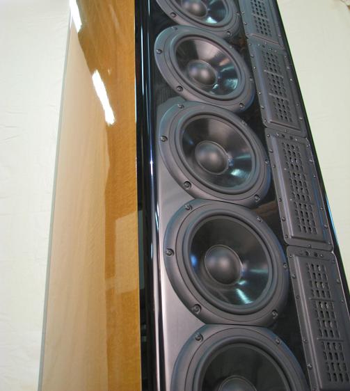

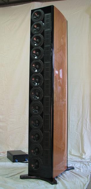

It is sort of what I was planning for the LS's if I built them. The contrast of light and dark makes it, as well as the fine workmanship of course. I like contrast. This wasn't the direction that I had planned for mine, but it is now.
What wood is that? Looks nice. What finish is on them? ????
And since I am asking questions, did you use a hardwood on the corners? If the corners are MDF, any advice to make edge grain not show? --not asking for any "trade secrets" but I am curious about this also.  If I copy this, can I get that piano look with just a sealer? What about a thin film of bondo? Or do we need to use hardwood?

Not bad. I see a little orange peel in the finish, but other than that... :green:
Gorgeous! Great job, Denny!

 Another method used was in the cabinet construction itself. While we did not stray from the preliminary specifications and/or volume of the design, we chose to go with a thicker, more rigid construction as well as a few internal features. Goimg with the denser cabinet also provides more control over system resonance. We then decided to take the crossover out of the cabinet to help reduce any potential vibration from entering the components and making their way into the music due to the amount of energy these speakers are capable of. The connection between the external crossovers is made via custom umbilical cords that utilize the same wiring as used internally within the speakers. There is a separate cord used for each the upper and lower frequency drivers as can be seen in the photo on the first page of this thread. Connection is made using locking Speak-On connectors. Again, more detailed information is forthcoming.

« Reply #39 on: 14 Nov 2007, 02:51 pm »
Couple more pics.
