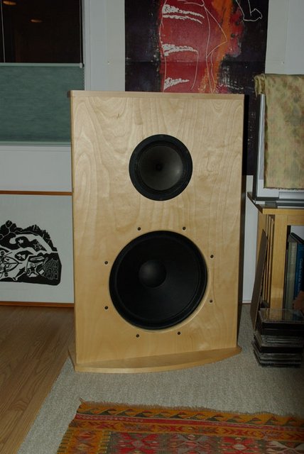

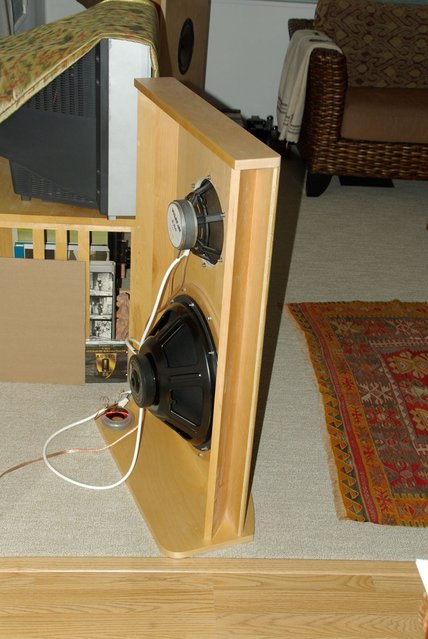

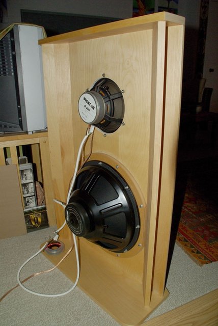

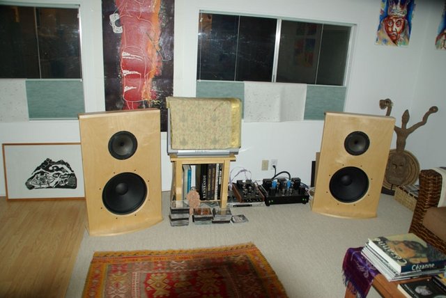

I have helped Richard to get photos of his baffle in this thread. Here are the pictures with Richard's comments.
'Here are a few pic's with comments below each pic that help to explain the structural elements of the baffles. I hope this helps
Note the curved base... also the Alpha-15's are attached on the back... more about this to follow. The B200's are set-in flush to the 3/4"
maple plywood.
Back shows the separate circular "ring" that the Alpha's are screwed onto... the screws for the ring are what you see from
the front as a sort of nautical "design" effect. Note the simple inductor sitting on the base... positive leads of speaker wire
hook up only... the negative leads tie to themselves (do not touch the inductor at all).
Note the very narrow "wings" that attach to the inside of the baffle and also attach to the shelve on the top
and the base below... Jim designed this for structural integrity... I might have preferred another design solution
but Jim went ahead on this without our chatting about it and I think it looks just fine and does not seem to effect
the sound adversely.
I stepped back on this shot... my main living space in this 1976 mobile
home is 20 feet wide by 26 feet deep... the OB's are on the right side
in the front of the mobile... the left side is our eating area... I took down
some walls when we first moved-in and made it into a loft style
large room.
Let me know what you think.
Warm Regards ~ Richard'
Well, I think these OBs both look and of course sound gorgeous !
/Erling
