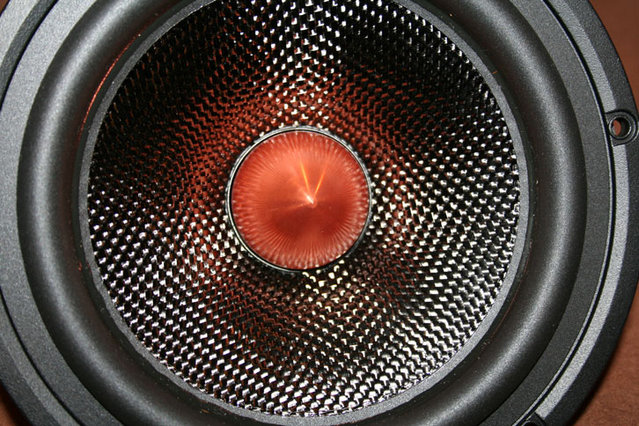

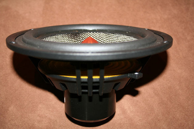

Below is the new look for the Apex III
In the Apex II is the new SDX7 woofer from CSS(more info on this driver in the coming weeks)
Here is a little taste of the over all look of the new driver.
For those who ever got a chance to listen to the Apex II with the old Extremis will be shocked at the out put of these new woofers.
They play lower,yes the NEW Apex III dropped a few hz on the tuning. aa As well the drivers are a lot cleaner and a more detailed bottom end due to the cone one these new drivers.
Over all really happy with the new woofers, and they are just that woofers not midrange drivers but a woofer.
As well on the Apex III we have the EnAbl process applied to the mid range drivers

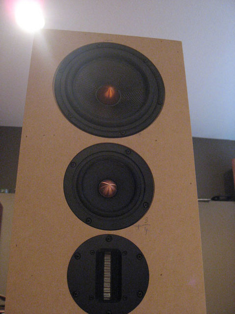

« Reply #9 on: 6 Nov 2007, 08:57 pm »
Would they drop into the HT8's.... ?     :drool:
RAW
Re: New look for the Apex II with the NEW SDX7 XBL^2 woofers
« Reply #10 on: 6 Nov 2007, 10:18 pm »
Yes they do.
Same crossover no issue at all.Just a little smaller cut out, so some of the hole will show from the Extremis.
But the new look is great.

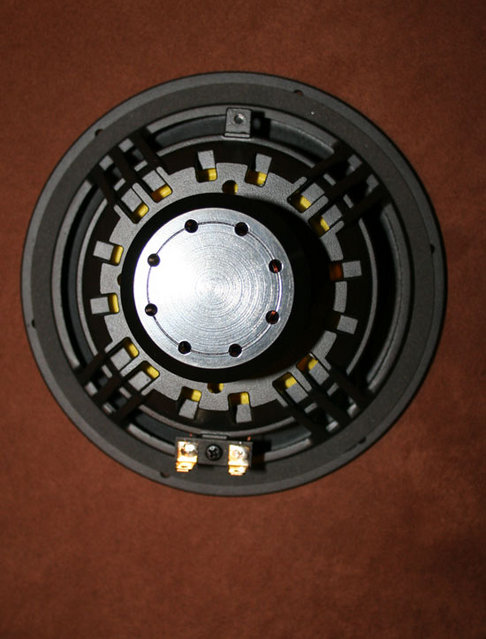

« Reply #14 on: 7 Nov 2007, 10:20 pm »
Triple copper shorting rings with large vent holes on the rear of the Neo motor.
These are just a few new things done to this new driver over the Extremis.
