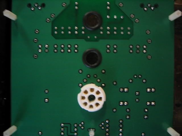

Bob, tried the clarinet plug on the cornet with no luck. I tried cheater plug with no luck. I performed visual inspection of joints and think they look great. Here are a couple of not so great pics.

A visual inspection of the solder joints may not be enough. I had an intermittent noise problem that was finally tracked down to a perfect looking solder joint. Look closely at both sides of the board and touch up all the ground points.

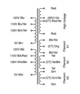

I decided to twist the tranny leads next. You have to take caution here not to just twist all of the wires together which could cause more problems. Here is what I did. On the primary I twisted blue and brown, black and white. On the secondary I twisted red and red, yellow and yellow, green and green. I think I did this right. This did not fix anything so probably is unnecessary.
