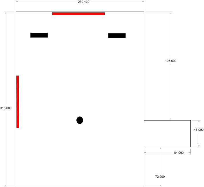

Wow this really is going to be a big job for you! And, wow I had a hard time making all of the software conversions necessary to upload this drawing (5, I think)!
Anyway...this is your room and you want the windows covered, correct? Also, the back wall is a garage door that you want covered?

Wow, that's a much better pic than mine was.  Your rendering is pretty close, except for the back right corner, as illustrated below.  Also, in your rendering, it looks like the window to the listener's left side is offset towards the back, when in fact it is a few inches closer to the front wall than the back wall.  If I made a mistake when describing that before, I apologize.  The back edge of the window and the front edge of the hall are ~even at ~about 16.25 feet feet back from the front wall, give or take a few inches, IIRC.
Anyway, it's definitely close enough to get the idea.
I wanted to cover the entire door frame and window frame, but not the entire garage door (pictured in illustration below).  I just wanted something that looks kind of symetrical to the front wall diffusor, a stand alone unit to place back there somewhere.
Thanks so much for your time.

Ok, here's the general areas.  Notice the circles around the speakers and listening position.  The speakers and listening position could end up anywhere within these circles, whatever sounds best, and dictated by the position of the side window covering diffusion panel.
The front (green) panel needs to be 6 feet wide by 8 feet tall minimum.
The side (orange) panels should be the same size as each other (symmetrical), and to cover the side window must be minimum 56 inches x 56 inches, so I could make them a bit larger (6 feet x 6 feet) if we are making 2 foot square units.
The ceiling and back wall panels (blue) can be any size you think would be best (6x6, 6x8, 8x8, etc)
The green and orange panels can be larger than noted above, if you think there is sufficient cost vs performance ratio.

« Reply #30 on: 29 Oct 2007, 02:33 pm »
This is going to be a really, really big job. I am counting 46 panels before the ceiling gets treated.
On the sidewalls 6'x6' is fine. You have 3 options:
1. Make a total of 18 panels (9 for each side) make 10 of them an "11 well" and 8 "13 well" or vice versa.
2. Make some larger - i.e. 2'x4' panels and make fewer if that will save you time.
3. Use all "11 well" or all "13 well". In a checkerboard pattern, where one is vertical and the next is horizontal.....you really don't need to worry about mixing the 11's and 13's. This si my recommendation.
On the front wall at 6'x8' you have the same options as the sidewalls. I would recommend the checkerboard pattern with all of them the same (11 or 13), but use a different number than on the sidewalls.
For the back wall, I would go pretty wide....10' wide by either 6' or 8' tall. This is really the place where you can make tall diffusers if you want. 2'x4' or 2'x6' or even 2'x8'. Here you will need to mix them up some 11 and some 13 if you make the tall diffusers. I would recommend this option here. You would need to make 2 of one (11 or 13) and 3 of the other.
Jason
