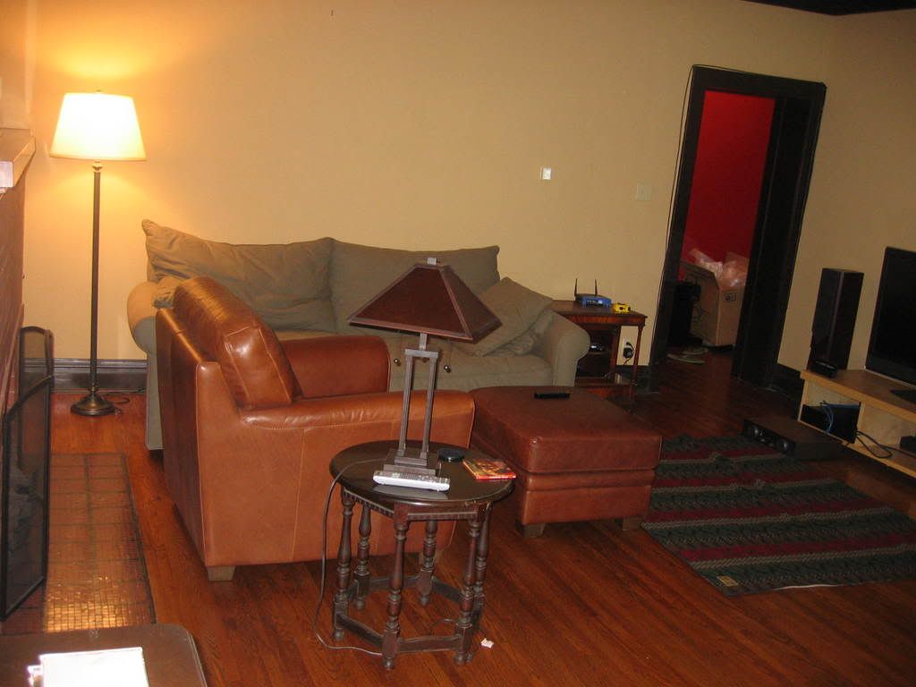

I'm holding out hope that a couple of big area rugs, curtains, and maybe a wall treatment that I can cover with a tapestry or artwork will make major changes to the sound.  I'm not looking for perfection here, just significant improvement.  So with that in mind, would an acoustical panel on the wall space above the console table do much for me?  Anywhere else on my walls?

I'm not giving up on this room yet.  So, based on my pics, and assuming I get curtains and a couple large area rugs, does anyone see any walls that would benefit from a reasonably sized acoustical panel that I could mask with artwork or a tapestry?  Again, not looking for perfection, just measurable improvement.
Another thing I might try is placing the speakers on either side of the TV and seeing what that does for me.  I would think having the sofa and club chair along with a nice rug directly in front of the speakers would help, no?

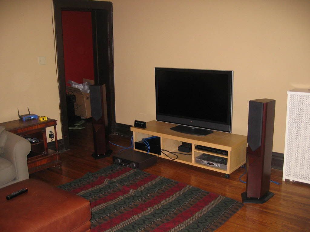

OK, here are pics of the new speaker location.  Based on my short listening session, it's too early to tell, but I don't think it sounds any worse than over by the windows, and it certainly seems like this new location offers much more potential for unobtrusive treatment.

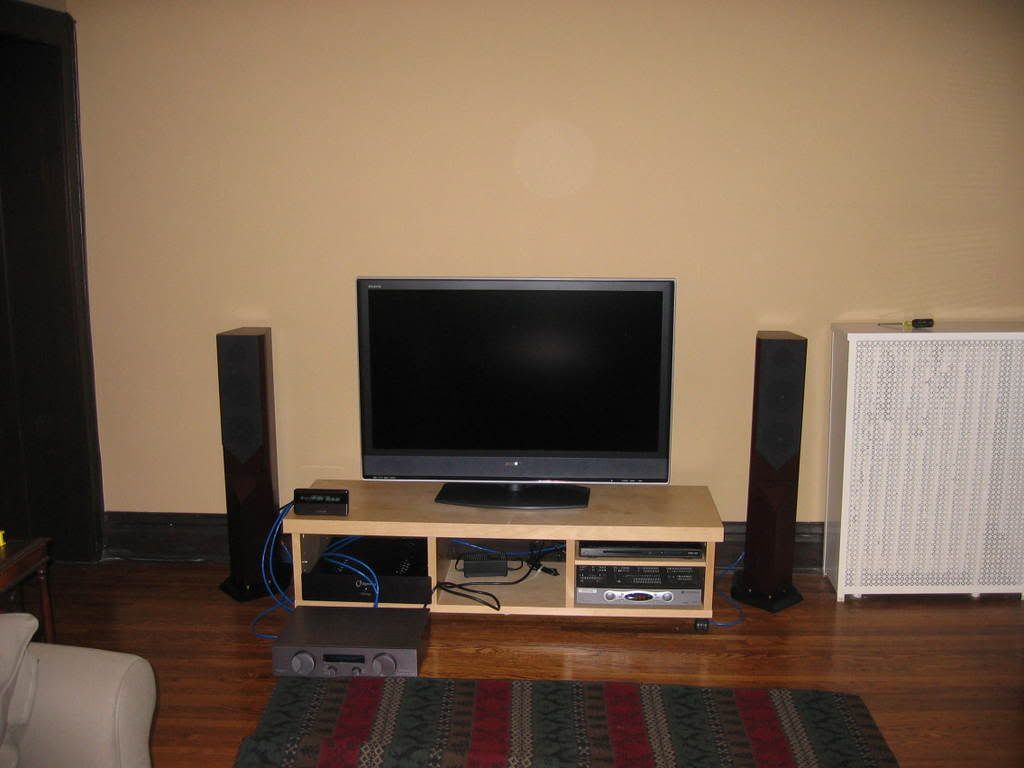

This shows the speakers tucked away right against the walls.  This is where I'll keep them when I'm not listening.  FYI, that's just a heavy wool blanket I've been meaning to take to the dry cleaners, standing in as an improvised rug - not sure if it's making a difference.
Here they are brought out into the room a little bit more.  I presume this improves the sound, but haven't really evaluated too much.  As you can see, I've got a fair amount of wiggle room to play with for each speaker.

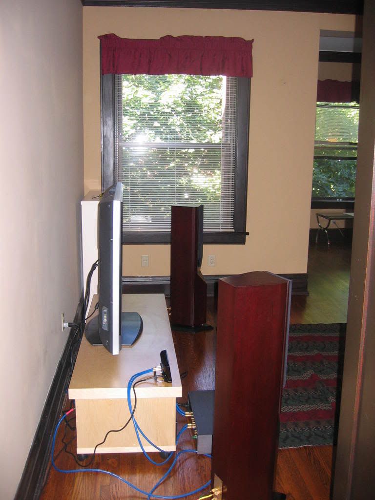

Here's a side view of the same, to show how far out from the walls they are.

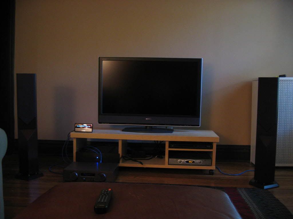

Here's one from the listener's perspective of that speaker location as well.  Before moving them to this location, I was worried that the sofa would block the left speaker somewhat, but that doesn't seem to be a problem.

This is far, far better, right?

In my opinion yes.  You have more room to play, more room beside the speakers, no windows to deal with, etc.
Also, if you treat the front right corner for bass control, you don't have to worry about symmetry as the doorway on the left front acts as a 'hole' for bass anyway.
