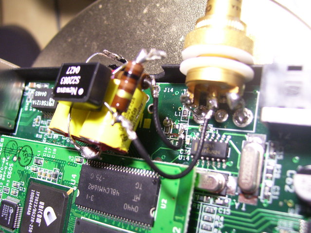

Excuse me, but where did I say to stick in a 47 uF cap?????????????
I didn't.
I suppose that you could. It would have a "+" lead that would have to be at least 5 mm long, which is not a lot of good at RF. Sure, it might help at the lower frequencies, in which case the added length won't be a problem. Expecting it to clean up the RF garbage.......ain't gonna happen.
Unless you can live without the PCB that houses the "Wi-Fi" card (and a bunch of other stuff). Either that, or get a cap that is very small.
Mr New UK:
That 300 ohm resistor should be 249 ohms......just as in the original circuit. Your level will be too low at that value. It would work if you were running on +5 V. You are not.
The trace to get cut is under the chip! Why do you guys think that there are no pictures of it???? (It is just to the left of the via on Mr. UK's photo. Nice photos, btw. Wish I could do ones that nice.)
Speaking of which: what is "new" in the UK?  A former business associate (who is from there) liked to say that the reason it is now called the "UK" instead of Great Britain is because nothing is great about it any longer. (His words, not mine.) (He sounds more like Enoch Powell every day, which is funny because he is the sort that Powell ranted against.)
Pat
Where did I say that you did?  :wink:
The NXQ is about as small as you can get for an electrolytic and should be able to go right on the pin. If not, I reckon the corner of the daughter-board could be cut away to accommodate it!
I 'pinched' that one off Gary!  :oops:
So here is today's version of the circuit:
If anybody knows just cause or impediment why the above circuit is not correct let him speak now or forever hold his peace!  :lol:

« Reply #134 on: 25 Jan 2008, 02:20 pm »
Those yellow caps look very big, won't the inductance be too high  ?

Also as i read it the "pinched" comment was refering to the picture NUUK used/re-posted.

I think Nuuk was giving me credit for the photograph of the board - not the schematic.  And he's right - I did take that picture showing where one connects the transformer.  For those interested in how to take pictures like this, it's quite easy with modern digital cameras.  I got a new Olympus Stylus 820 for my birthday and it has a very good macro mode.  I made sure the board was well lighted and then just took the photo in macro mode holding it my hands - nothing too difficult.  Just takes steady hands.
Regarding the rest of your post, I agree completely.  These are high frequency circuits and capacitors that sound good at audio frequencies don't necessarily work well here.  A couple of pages back I recommended just reusing the 0.1uf ceramic capacitor that was originally used in the SB3.  That's still good advice.  Pat has suggested one gets a little bit of tilt in the square wave and it might be worth increasing this slightly.  Adding a bigger ceramic cap would be fine but I'm not sure it's really worth the effort.
