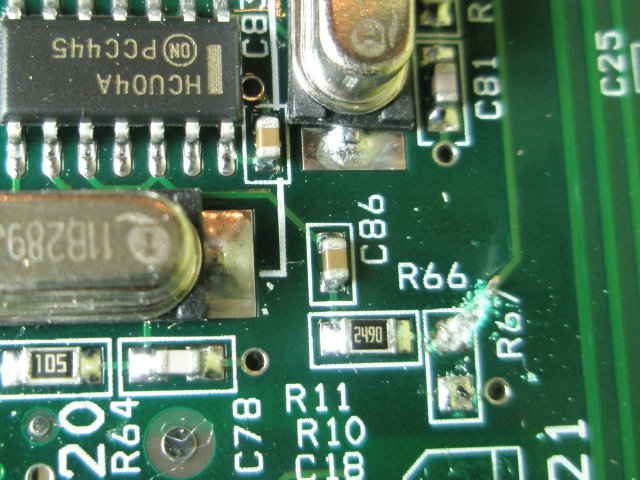

As Randy said, the correct schematic is the top one, which I've reproduced here.
I've taken a photograph of the spdif circuit in the Squeezebox so that you can see how this maps to the existing circuitry.  Here's a photograph after I've removed one of the resistors in the circuit and cut the trace going to the output inductors and the SPDIF jack.
C86 is a 0.1uf capacitor and is the 0.1uf capacitor that you need to block DC.  We can just reuse this capacitor.
R66 is a 249 ohm resistor and is in series with the 0.1uf capacitor and the chip outputting the SPDIF signal.
R67, which I've removed, was a 107 ohm resistor and went from R66 to ground.  The SPDIF output was taken from the junction of R66 and R67 and ground.  You can see the trace going to the output inductors and then the SPDIF output going to the right and then up.  I cut this trace so the stray wiring was no longer connected.
The primary of the transformer should be wired between the right hand side of R66 and ground.  I use the round hole just to the right of the R67 bottom pad for ground and hooked a small wire to the correct side of R66.
The secondary of the transformer should be loaded with a resistance to give an effective 75ohm impedance.  This would be 107 ohms if you reuse the 249 ohm resistor.  Of course you can play with different values of resistors, but this is a simple starting point that should work well.
---Gary

If I accidentely removed 249 resistor at R66 in my other SB3 could I solder another resistor (not the SMR) from the C86 (0.1 cap) and use the ground of the right hole at R67 to connect to the pulse transformer secondary would that be okay? Thanks in advance.

. .  could I solder another resistor (not the SMR) from the C86 (0.1 cap) a
Tan - of course, you can use any resistor you want.  There's nothing special about the surface mount resistor that was originally in the SB3.
The top picture is the correct one, except that the cap is on the "cold" side of the primary winding.

It was just easier to connect one primary pin to the chip, via a resistor, and the other primary pin to ground via a cap. Simple as that.

The "inductor" (ferrite bead, actually) is marked L8 on the unit. It lies behind the big 220 uF cap for the +3.3 V supply, right under where the TOSLINK is on the right angle daughter board.
It connects to R67, through 4 cm or so of PCB trace.
Pat
Edit: Typed L8, but screwed up and posted L9. L9 is a zero ohm jumper that provides ground for the RCA jack.

A big thanks to Pat and Gary. I have now modified my SB3 and even after a few minutes can say that the output is much closer to the Transporter. I still haven't located any mini coax cable so have had to compromise slightly for now.
I removed the 107 resistor (R67) and soldered it to the bottom of the connector PCB under the output socket (BNC in my case). I removed C86 but left R66 in place as it won't be in circuit. I then soldered a 0.22uF cap to the input pad of C86, with a 300R resistor attached to the other leg. The other leg of the 300R is soldered to the pad of R67.
