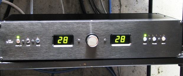

The prototype of the collaboration between BOLDER, Bent Audio and Burson Audio has arrived in Colorado.
This fuzzy picture doesn't do the casework justice. It is very cleanly machined AND labeled.

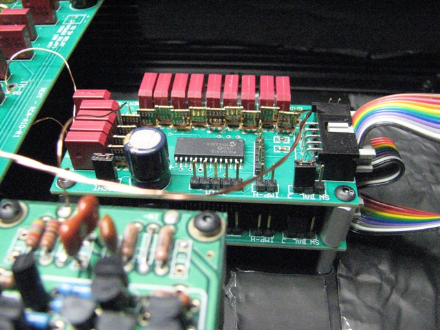

John Chapman of Bent Audio spent quite a bit of time and money in designing a great "system" that can be used to switch inputs and control levels all without the more common mechanical switches. This unit is designed from the get-go to be used with a remote control. All the source selection is done through extremely high quality, sealed relays. These relays are rated to have a MINIMUM life of a BILLION cycles.
The volume control is also relay operated. This design is a "cleaner" method of attenuating a signal than a standard variable potentiometer. The resistors used in this version are the VERY accurate Naked Vishay 102s

I sent him some modded Buffer modules, a modded power supply board and a transformer. He was able to interface the Buffer parts with his TAP system. I received it yesterday. I did do a little mod work to his layout and damped the chassis. The unit has been running for about 24 hours now and I am VERY impressed with the sound of it.
I am more than halfway convinced that the relay controlled stepped attenuator into the Burson Buffer sounds better than using the SB's internal volume control into a modded Burson Buffer. It is a little hard to do direct comparisons and I don't have a lot of time this week to spend on comparing.
