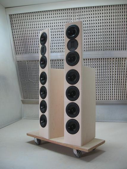

Here are a few pics in the prototype box.
This offers the same center section as the previous OB-7 design (now being called the OB-7 Plus), but moves all four mid-bass woofers to below the upper MTM section. This one is easier to build too.
All four woofers are also in a sealed enclosure, so low bass extension is not as low as the OB-5 that uses a pair of M-130/16's in a ported enclosure. However the bass response is very tight and clean. It is designed to be used in conjunction with a sub.
This new version will be offered as a kit for only $875. This includes all of the best components including Sonicaps.
I will also be offering this model with the new M-130X woofers (lower woofers only). This further extended the bottom end and increased output in the 80Hz and down range. Distortion was clearly lower from listening comparisons and cleaner as well. With the M-130X woofers the kit cost will be $995.

Danny, I am ready to begin my OB-5 installation. I chose the OB-5 over the OB-7 because I wanted the top section open. Cost issues aside, what are the pros and cons of the new design compared to the OB-5?
Danny Richie
Re: New OB-7 design
« Reply #6 on: 6 Jun 2007, 01:25 am »
The OB-5 is going to play a little lower.
The OB-7 has a more gradual roll off that will give you less room gain in the lower region, but will be a little tighter and cleaner. Distortion in the lower ranges is lower with the OB-7 especially with the M-130X woofers.
The OB-7 is designed to be used with and integrate well with a sub.
