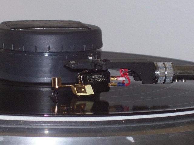

Pickering XLZ-7500-S mk. II cartridge
« on: 30 May 2007, 05:46 am »
I'm nearing 44 now...have been dinking with TT's for over 25 years now [ah, hell, I'm getting sad just adding up the numbers now :cry:]  I was late to CD having purchased my first player in 1992....actually, it was given to me by my (then girlfriend) wife.  It was a lovely Rotel RCD-965BX.  It never sounded much like music, but it was great background for hours of playing in the background.
From late-'94 to early 2000 I had all my audio gear packed away as I knew this addiction would draw my attention away from my new marriage and new business during those years.  I listened to a boombox for 6 years and attended many concerts in Washington DC during those years.  I'm not sure I was any the worse off for having done so.....but, I did miss the bonding of fine music in my home and me in my comfy chair; not sure I missed the overcritical analysis of music that often comes with audiophool-dom.  I guess we all here at AC have that in common - if not much more than that.  A good bond, nonetheless, eh  :thumb:
Right after I broke the audio pieces out again in 2000 I somehow decided I was going phonograph free.  For over 4 years I had no vinyl an assortment of CD players and DAC's passed thru.  Never have I loathed music more than during that time - the boombox was more enjoyable as I expected nothing from it.  Only about 2 years ago I bought another (cheapie) turntable from ebay and, shorning it with a way-too-bright AT440ML/OCC I still knew this was music.  It was clearly far from perfect - but was mostly to my liking so I continued ever onward. Thank goodness I didn't give away my 400 album collection in the proceeding years  :roll:
Shit - it's late now but I felt poetic tonite so I began to write despite the time - suffice to say I really like this cartridge, the Pickering XLZ-7500-S mk. II.  Despite it's rediculously long name, it sings more beautifully than the other cartridges I own or have auditioned to date.
Tomorrow, with a good nite of rest under me, I'll try to explain why I like it so.
Here's where I got it and a bit more about it in the meantime: http://www.pickeringuk.com/

I probably logged another 5 hours on the cartridge today - it might have 12 total on it so it may well be nowhere near run-in yet.
It has only 3 ohms of impedance/resistance....only a handful of cartridges costing far more have that or near it.  The Grado 0.5mv series are exceptions as well for $300+....which I kept thinking of getting, but something about spending $500 or $800 and still getting an elliptical stylus was bothering me.  This $260 gem from Pickering has almost identical specs to the Woodie Statement Grados....but offered a Stereohedron (nee, shibata or CD-4 type) stylus for less.  Normally, it costs 2x that, but Pickering UK was having a half-price sale on ebay so I decided to try it.
Low, low impendance means you get more signal.  Less coil turns leads to less voltage output (still respectable 0.33mv), but vastly less impedance.  It's as close to no resistance at all, so you get every bit of what was cut into the grooves. Coupled with great tracking (equal to the best out there at any price) and Stereohedron tip...you simply can't get more signal passing thru.  At high volumes, this is the only cartridge I've ever owned that equals (at least in my room) the dynamic punch/snap of (some) CD's - it's really thrilling for me  :thumb:
As has been said of the similar Woody Statement Grado's, it's a tad 'veiled' next to low output moving coils (the only one I have to compare is Woodsyi's MC-3 on loan...but it's representative of the breed).  It has respectable inductance figure of 1mh....but that is still some 20x MORE than moving coils of this output voltage have. Lower inductance = more extended treble...ie., less 'veiling'  So, you don't quite get that insanely intimate 'imaging' connection with the music that one can get with moving coils (even high output/ 2.0mv+ MC's have better inductance figures than 1mh).
The trade-off for me is worthwhile....as I keep hearing falseness to moving coil treble.  I do understand the 'magic' part of it's design...but I suppose I side with Joe Grado who thought of moving coils as flawed mechanically no matter.  Tho when one spends $1000+ for a MC tweeked by a master builder, much of the 'false' have been tweeked out so you're just left with magic.  For the type of money paid for this Pickering, I'm not sure one could do better with a moving coil.  AT0C9, mid-line Benz and Denon fans may disagree, I know, and that might be my next step is to hear those designs before passing final judgement on MC's.  Thus far I hear a falseness to the treble registers that renders them hard to listen long to.
I really am forming an judgement that ones opinion of a cartridge is perhaps 65% electrical, 30% mechanical and 5% subjective based on your individualized hearing, memories of past or interaction with your other components.
A moving coil is absolutely superior in inductance so it is less veiled. Lower inductance = less coil noise, so less is amplified at 60db+ gain...further adding to the reality of superior transparency. A low output MI/MM can be designed with class-leading impedance figures....so it will sound full and robust.  Further, it need not have as much damping applied to it due to it's less 'flawed' mechanicals (all of vinyl is flawed, it's just relative to other flawed parts of it)...so it sounds even fuller as less damping is required of it in design.  This particular Pickering is also fully shielded with an annealed metal cartridge body...so it's stone dead, quiet...adding to the fullness and slam. But, it will always lack that last degree of delicacy that moving coils have of even similar cost.
It's a tradeoff, as are most things, but one I currently happily make as I still can't handle moving coil treble for long (even loaded correctly).  fyi - I'm pretty sure it's the amazingly insightful Linaeum tweeter exposing it...those using lesser capable tweeters may not hear what I hear.  I'm not saying my speaker is world-beating...only that the tweeters might likely be. My hearing is otherwise average, so I suspect that MUST be the case.
One thing I have banished, common with low impedance moving coils designs too, is a 'compression' I was hearing on demanding orchestral and piano passages.  No higher output cartridge banished it.  It turns out it seems to be that the lower impedance let these demanding passages pass, while higher impedance designs choke it off.  That alone is reason enough for all to consider a low output cartridge - it's worth the expense of step-ups, etc, just to banish that from your listening pleasure.
The Benz MC-3 almost banished it...but at somewhere around 50 ohms of impedance, it still wasn't quite up tot the task of pulling thru the demanding signals thru the pipeline. Low impedance = punch and slam, for sure  :rock:
So, this is the finest cartridge I own to date...because to is electrically superior to the rest in my burgeoning collection, and is less flawed mechanically than most of them. That makes it numero uno  :guitar: in my book - and a cartridge I rate highly and recommend.

Some additional notes on the Pickering XLZ-7500-s Mk. II as I continue listening to it...
Bear-in seems to have occurred fairly quickly.  At 20 hours I could discern no additional benefit from run-in.  I have about 30 hours on it now. Some makers specify 25-50 hours, but this was my finding on it.
Dialing in the right tracking force really counts...as is usually the case.  Pickering optimistically indicated a range of 0.75 - 1.5 g of force.  As most have found when there are ranges indicated - the highest number is usually about right. It tracks best here at about 1.45g.....I tried lower and it wasn't coping well.  I haven't tried higher just yet - it sounds right to my ear (about the only way you can dial this setting in correctly).
Don't know why makers specify a wide range like that when it all boils down to their highest selling + or - maybe 5%.
Quality control, at least for one parameter, is suspect.  Channel balance is off by a bit more than 1db....corrected by tweeking balance knob. 1 db difference messes with stereo imaging pretty severely until corrected with a twiddling of the dial.  My ADC XLM is off 2db - far worse - but that cartridge costs a lot less then and now.
Note for PA - the Stanton CS-100 arrived today.  It's got the prettiest, and stubbiest wee cantilever I've ever seen.  It's sapphire coated and tracks lower than any Stanton/Pickering ever specified that I know of (0.75 - 1.25g).  It's frequency plotted by hand and is QC stamped.  Nice wood case, too.

Soooo, all this time I was tracking at about 0.5 gram  :duh:  Still, it worked, I was not thrilled with teh tracking, however, but it sounded pretty good.
Seat that Stereohedron needle down into the grooves right and you have a superb cartridge.  There is so much in those grooves to enjoy now...the Pickering really digs well at at. The whole musical palette is now fuller, each instrument is bold and full....the difference between CD and Vinyl is now minute in those areas where vinyl was previously a bit thin.
Yet, my vinyl now has all that fullness, very little intrusive surface noise and emits a tight band of music north-south-east-west in my room.  Truly, thrilling, thrilling stuff - I am pretty sure it is the best vinyl I have ever experienced in my listening area  :)
I really recommend anyone with 60db+ of clean phono amplification available to them and $250.00 to spend on a cartridge to try this Pickering XLZ-7500s Mk. II.....it is truly a wonderful device.
30 years setting up turntables and I ass-u-me-d again I knew it all....frustrating this aspect of audio is, but so rewarding when you get it right  :thumb:
