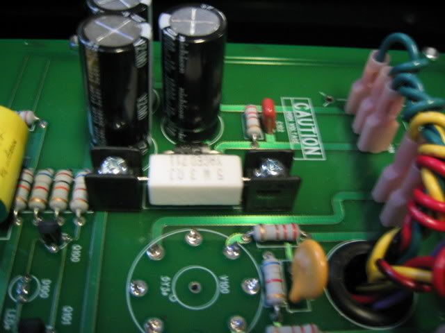

I open up my Cornet today.  Measured the heater voltage and confirmed 6.12V.  From there, I calculated the current across the ceramic resistor and come up with 1.5 ohm resistor to give me approximately 6.3V for the heaters.
I use a 10W 1.5 ohm (Eagle Brand) resistor.  After installation, the voltage measurements were as follows:
One side of the resistor(between R223 and C209) with respect to ground = 6.29V
Heater pins (4,5) for the 12AX's and 12AU = 6.28 Volts  (6.27V after 20 minutes)
Results:  In my opinion base on my system, I think there is a substantial improvement.  Maybe because the bump up heater voltage (from 6.12V to 6.27V) at 150 mV difference made the tubes operate better.  I do not know why but if people reading this who owns the Cornet2 have some time to kill, check your heater voltages and verify it is close to 6.3V.

One thing to keep in mind is the in-coming line voltage. Since summer is coming (101° F in Tucson tomorrow) setting the H+ voltage on a low voltage afternoon will result in too high heater voltages late at night. I recommend keeping a log of your house voltage to see how close it stays to 120V and adjust accordingly. Heater voltages over 6.3 is not a good thing.
Hello Wayne,
Very good point!  After reading your post, I did a little observation experiment.  I waited until its close too midnight here and see the results when the AC is at its peak where I am at.  I am a little surprise of the results being lower compared to the previous measurements I had.  But I think that I will go with this data instead.
Here's the resistor pic
Here's the measured AC at the wall
Here's the voltage reading just before the resistor
After the resistor...
the voltage at the last 12AX7 (front)
In my opinion, it will take a considerable swing in the AC supply to produce greater than 6.3 Vdc in my unit.  Looking at the very first pic, you will notice that the resistor is 1.5 ohm 5% (non inductive type).  But it really measures at ~1.7 ohms.  The original value was 1.8 ohms 5% (the ceramic one).

I installed these terminal blocks
http://www.mouser.com/search/ProductDetail.aspx?R=571-214376679
where R223 (cornet2) and R313 (clarinet)go to make the resistors easy to replace when tube rolling the rectifier.
Note that the t-blocks are 4 position and that I cut them up to make two single position t-blocks. A three position one wound have worked also. The only other thing I had to do was to trim a little off the pin that penetrates the pcb being it was a litlle bit bigger than it needed to be.
