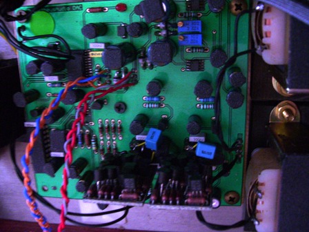

tanchiro58
Re: Promitheus DAC anyone?
« Reply #302 on: 2 Jul 2008, 03:48 pm »
also from what i did to help out a local customer we bought the fame 10nF MKP Roderstein stuff and bypass across +v supply to ground, -v supply to ground and +V supply to -Vsupply. Really improves the burson quite a far bit. ITs hard to solder them though
Nick,
Are they little square turquoise blue colors (Vishay 1837 MKPs?)? They are exceptionally excellent to bypass the Burson Discrete opamps and sound good too. I got the stable voltage between 11.30 to 12.30 VDC (pin4 and pin7 regarding to ground 0VDC) as you told me to adjust the other days but the Burson run warm would that be normal?
Analomart,
Do your Burson run warm or hot? In Fountain Valley (Southern California-USA) I always have 118-120V.
Many thanks,
Tan

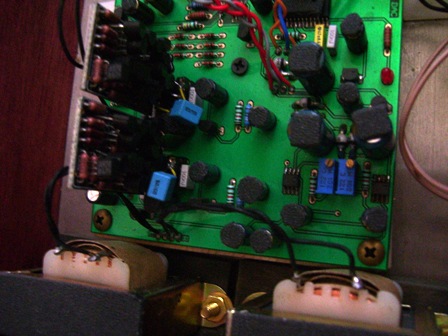

tanchiro58
« Reply #305 on: 2 Jul 2008, 05:43 pm »
Some of you have different (earlier) Bursons - I cant imagine, can you post the photo?  Thanks
Dexsam,
I got the early version of Burson opamps with Vishay 0.01uF 1837 MKP and here are the pictures (sorry for not enough clarity!!!)

Dexsam
  • Posts: 10
« Reply #308 on: 3 Jul 2008, 11:25 pm »
Tan,  nice pictures you have there.  I notice a few differences, maybe Nic can eloborate.  Your DAC board looks like very close to the wood base (touching?), there's an air gap about 10mm in mine as the pcb sits on studbolts.  The output to the trans is twisted pair of cables (black) whereas in mine, its single strand solid core copper wire run parallel, no twisting.  The Bursons are essentially the same, only the lead out wires are different and looks like you inserted them into the IC sockets?  Can the top lid be put on with the Burson in place?  I notice cut pieces of black foam stuck to the top of the electrolytic caps, what are those?
For me, I will be changing the power supply to variable type using LM317/337 in place of the LM7815/7915 and individually adjust the supply rails to the Bursons to achieve the near zero dc offset following Nic advice.  Will check out those tantalum caps Tan mentioned. Cheers.
tanchiro58
« Reply #309 on: 4 Jul 2008, 03:53 am »
Dexsam,
When I got the DAC it was nothing except PCB board, transformers and other components. Since I believe spruce board (pine wood) helps a lot in preventing vibration especially those components on the pcb I modified the Promitheus DAC based on Altmann Attraction DAC model (I own too). I also padded some of black hole pads on every capacitors and chips once again preventing the micro-vibration. I added underneath the output transformers with two pieces of ebony wood too. I also replaced and twisted all the wires of the stock DAC with OFC silver plated wires that I got from my friend. That is why the reason I said about the comparison between Promitheus and Attraction DACs.
Yes, the Burson opamps in my DAC seat on the sockets that Nick gave me the option of swapping different opamps around. Therefore, I absolutely love the sound of my DAC now. I might not need to replace the resistors as Nick suggested since it might change the sound I have right now. Besides the output voltages by the opamps are stable in my DAC.
Tan
