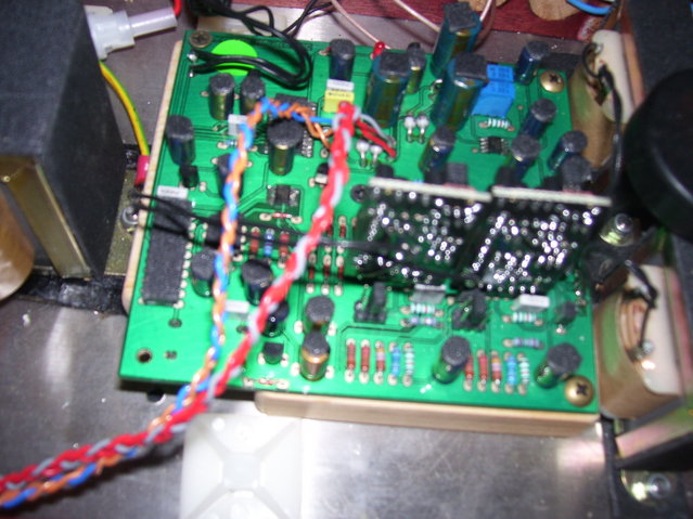

Just thought I'd post after a bit of a revelation last night after listening to my promitheus DAC after a recent tweak....First off, I bought the DAC second-hand from AC or audiogon and received it back in December...In a head-to-head comparison with my modded Paradisea DAC, I preferred the sound of the stock Promitheus using either a Denon 2900 or SB3 as the source...In fact it was so night and day that I sold the Paradisea...My take:  better PRAT, impact, soul, body and less mush...I think the Paradisea through my SET system (Welborne Ultrapath-> DRD45 -> Bastani Prometheus OB speakers) was just too soft sounding and lacked any bite...
So, anyways, last night I installed a pair of the Burson discrete op-amps using a Hovland musicap (0.33uF) bypass cap and WOW!!!  Right off the bat without any real break-in, the sound was simply stunning...I could now hear the piano and guitar string decay...the notes seemed to hang in the air alot longer...I could wax poetic for awhile about how impressive the sound was...I cant say enough about giving these inexpensive circuits  (~$100USD) a try in your DAC...Nick deserves much props for putting in the DIP sockets to enable very simple op-amp changes...

Hi, posternutbag2000
Where did you put bypass cap in the dac?
My Burson is coming on the way, it will replace BB627AP.
Cheers,  :D
Cheers,  :D
Mart
Here is the link of how to install the Burson Discrete Opamps with bypass caps:
http://www.bursonaudio.com/Burson_Discrete_Opamp_101.htm
It had a stunning sound too in my Promitheus DAC after replacing the NE5534 opamps with Burson Discrete Opamps.

« Reply #228 on: 9 Jan 2008, 06:35 pm »
Like Tan said (and thanks for the recommendation of the Burson discrete op-amps :thumb:), I installed the bypass caps as Burson indicated in their 101 op-amp tutorial...basically for the single version which I used, it was across pins 4 and 7 on the op-amps...a bit tough to solder with the large leads on the Hovland caps but in the end got it to work fine...

posternutbag2000
Re: Promitheus DAC anyone?
« Reply #231 on: 15 Jan 2008, 06:18 pm »
For your basic op-amp swap, you do not need to solder as Nick provided the simple plug-and-play 8 pin sockets...for the Burson discrete op-amp change, you do need to solder but its a fairly painless procedure if you just want to swap out the op-amps as all you'll need to do is solder the ground wire from the bursons to the RCA output or a similar grounding spot (I used the transformer lead which is connected to the RCA ground)...Burson also recommends as an improvement installing a capacitor (0.1 - 1uF) across two of the Op-amp pins which is bit more difficult but not too hard....
Hope this helps and if you need further help let me know...

« Reply #236 on: 26 Jan 2008, 04:39 pm »
Hi Tan,
Where did u connect the ground wire to? Did you solder any by-pass cap in the Burson Discrete Opamps? It mentioned that the cap between Pin4 & 7 of the opamp, any marks/indications of the pins in the opamp and what about the polarity of the cap ?
Besides the details,  any other major improvement after opamp changed?
B. Rgds
Andis

Hi Tan,
B. Rgds
Andis
Andis,
If you look closer to the above picture you will see the two "black wires" going from the Burson Opamps to the screw at the main power tranny where there is a ground wire located.
I use Wima film caps to bypass at pin4 to pin7. As you know film caps are not polarized so you do not worry about doing wrong. However, choose a smaller caps is best way to do. Good luck.
Here is another picture showing the two square blue green caps.
There is a big improvement over the stock opamps in sonic exactly what Burson website described.

tanchiro58
« Reply #239 on: 29 Jan 2008, 10:56 am »
Tks Tan,
I think I will order this opamp,  should I just mention to Burson that I need a pair of single opamp to replace NE5534?  I found the price is around AU$100 for the single opamp,  is it correct?
Cheers
Andis
Here is the link
http://www.bursonaudio.com/Burson_HDAM_Module.htm
And the price: if you buy directly from Burson I guess a pair of single opamp costs AU$85 which replaces your NE5534s
http://www.bursonaudio.com/Sales.htm
After installing the Burson Opamps you can not put back the lid or cover of the DAC unless you manage to bend the Burson opamps. Good luck.
