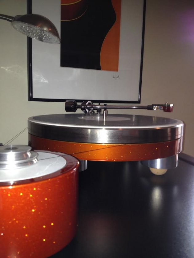

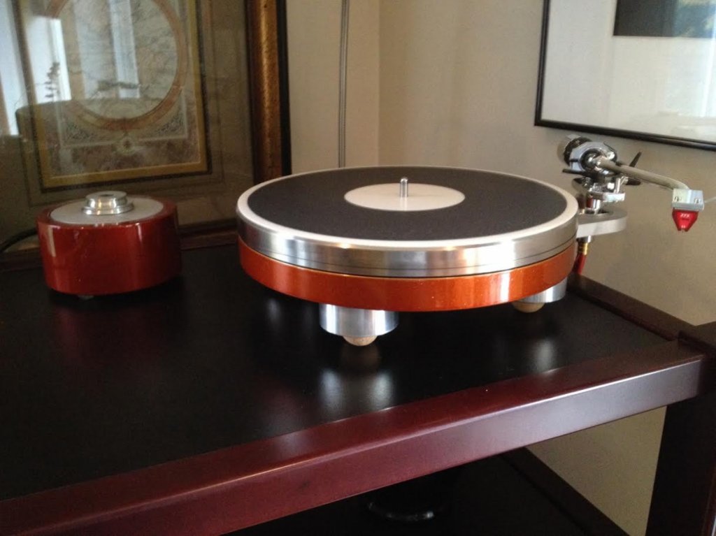

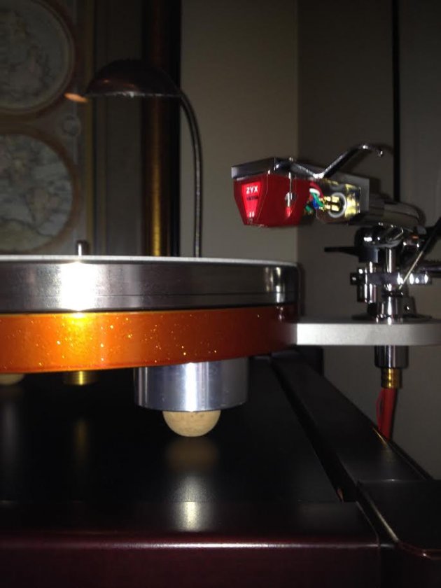

Hey there, my first post...new member. What a great forum!
  I have used this reference as a learning guide along with the Hi-Fi News test record. As a newby, this link summed it up best for me. I have a Polestar arm and a ZYX cart on a new table I received late Oct 2014. Its been a great ride so far... "Anvil Turntable" made here in Detroit.  Falling in love with all my old favorites and spending lots on new vinyl. Check out the pics. Thanks for a great site.
orthobiz
Re: A Beginner's Guide to Cartridge Setup
« Reply #19 on: 24 Jan 2015, 10:30 pm »
Looking good and WELCOME TO AC!!!!!
