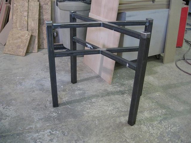

On the topic of resonance control, I'm building a custom metal stand for my audio gear. The stand pictured below is constructed out of 2" x 2" square tube for the uprights, and 1 1/2" x 1 1/2" square for the crossmembers, all .100" wall thickness cold rolled steel.
All the tubes were drilled and sand filled. Cross members included. The difference in ringing prior to sand filling, and after, is tremendous. Again, I experimented with tapping the tubes with various hammers of different weights, and materials. The sand is a big deal.
Just for fun, a couple of people told me that expanding uerethane foam (the same kind you buy at the Home Depot for air leaks) works well for damping. So I tried that with some spare tube. It actually does work really well at preventing the tube from ringing like a bell.
The other difference noted with this experiment, was that when the stand was flipped 90 deg. on it's side and you were to bang on the legs. The stand actually resonates like a tuning fork. You can actually see it oscillating. After sand filling, the oscillation is greatly diminished, and the duration is much shorter as well. Of course the mass of the sand will do this, while the foam could not.
Just to give you an idea on how much mass sand adds. The stand prior to sand filling weighed 50 lbs. After sand filling, 80lbs. An easy, cheap, and very effective method of mass loading and damping.
I'll definitely be doing it in the future for my new subwoofer enclosure.  :green:
I'm also experimenting with constrained layer damping for the shelves for this unit. I'll give an update on that when I finish those experiments.  :thumb:
