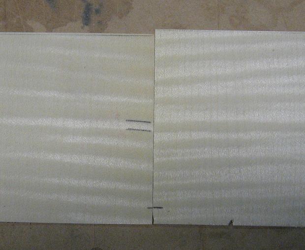

A new problem surfaced however. The bookmatched pieces did not stain uniformly as they  did on the first speaker. The pieces of veneer are  alternately light and dark (see the second picture below).
This is not a problem you caused, it is caused by the the lay of the wood grain.  When the book match was made, the veneer pieces did not just slide over to make the piece wider, but rather they opened like a book.  In doing so, the grain direction flopped 180 degrees.
If you change the direction of the light or flip the cab upside down, you should the light and dark area reverse.

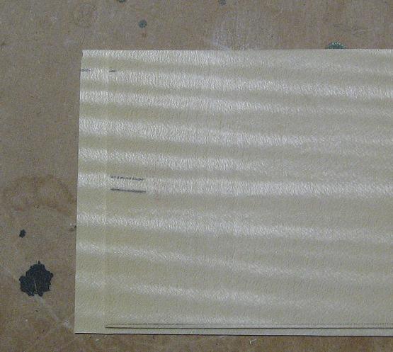

However, it might not necessarily be due to the softener. What Bill says regarding veneers is true. Here are some pics of some tiger sycamore:
These are sequenced as they were sliced off the log, one slipped over the other.
This is showing them bookmatched. Notice the color in between the two lines.

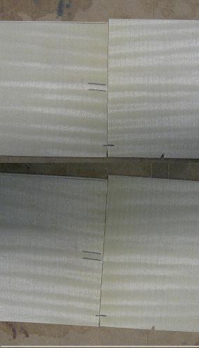

The same bookmatch, photographed from the same angle, only the veneer has been spun around 180 deg. Notice the color in between the two lines.
Now the bottom photo spun 180 deg. and put underneath the first one.
Sometimes the alternating dark/light in the bookmatch shows in the unfinished veneer, yet when stained, looks even. Sometimes it's vice versa.

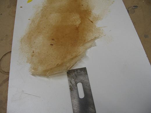

Mineral spirits will not work. The adhesive is water based,  very sticky, and stubborn. You need to scrape off as much as you can while it's slightly dampened with water, then if there is any residue still left, dilute that with water. If you are in doubt that you've removed it all, wipe the area with lacquer thinner, or mineral spirits (this will expose it, not remove it) . If there's any left, you'll notice it then. You'll need to keep cleaning it with water to get it off.

On the topic of adhesives. I just used some of the Titebond type III adhesive on a pair of OB 7's that we are currently building for a customer. I had some leftover dry on a piece of melamine, and I tried to scrape it off. It was stuck to the melamine like a cat on a screen door. :o I was hacking at it with a planer blade, and it was really giving me a hard time. Regular PVA glue, by contrast, just peels off.
