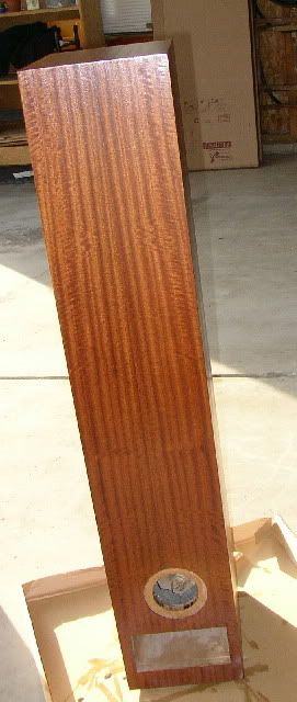

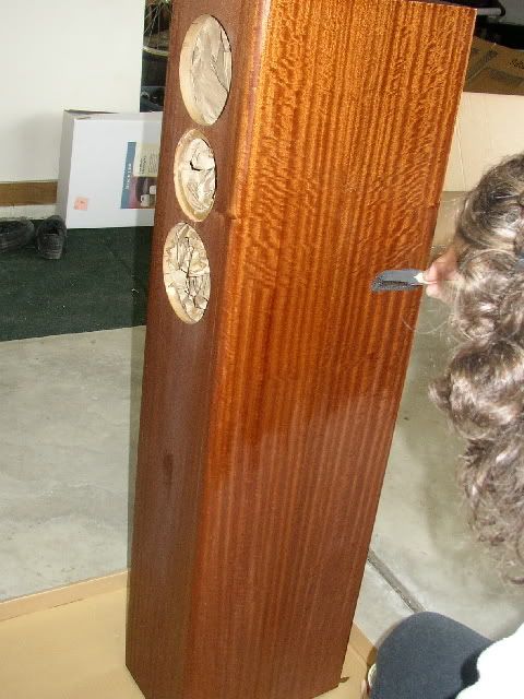

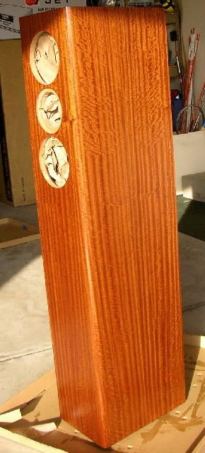

I've finished the first speaker. Here are a few pictures. I am very happy with the way it turned out.
First coat:
After four coats:
 Through trial and error, I ended up using provincial stain with Elmer's dark maple colored filler. I also tried golden oak, walnut, and cherry. I learned that I should have checked the color match in natural lighting rather than the fluorescent lighting in the workshop, but I still got a pretty good match between the stained filler and veneer. I will try to find a stain pen that covers some of the blems that remain.
For the next speaker, I will use pretty much the same approach (Titebond I iron on), but use veneer conditioner to ease the cracking when bending around the sides.
Thanks again to everyone for their input.

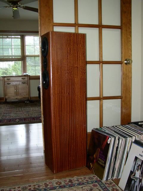

I finished the second A/V-3. As I said I would do, I pre-heated the pieces of veneer with an iron before trimming. The pre-heated veneer chipped and splintered more than on the first speaker, so I ended up having to add one more section. After taping the trimmed pieces together,  I used veneer softener to make the veneer bend easier. Doing those two changes resulted in much tighter fit, reduced cracking, and much better adherence of the veneer to the cabinet.
A new problem surfaced however. The bookmatched pieces did not stain uniformly as they  did on the first speaker. The pieces of veneer are  alternately light and dark (see the second picture below).  Another problem is that I can still see residue of the veneer tape (not picked up by the photos). I used TSP and it looked clean before stain, but next time I will use mineral spirits to clean up.
Before anyone tells me to used paper backed, remember I got this veneer for $25! I actually have enough left over to do my OB-5's, but I think I am going to use birdseye maple instead, since it is an non-endangered native wood.
All in all, a great learning experience.

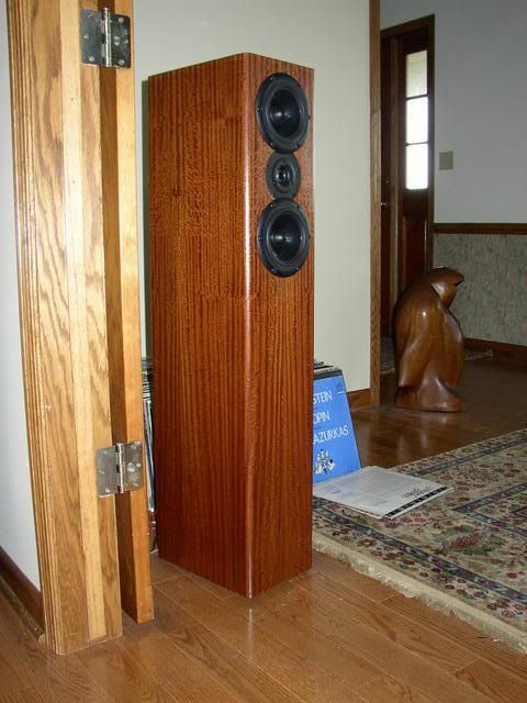

Here is a picture of my second speaker in location:
Bill A
Re: Need help with veneer...
« Reply #18 on: 3 Jun 2007, 02:41 am »
This is not a problem you caused, it is caused by the the lay of the wood grain.  When the book match was made, the veneer pieces did not just slide over to make the piece wider, but rather they opened like a book.  In doing so, the grain direction flopped 180 degrees.
If you change the direction of the light or flip the cab upside down, you should the light and dark area reverse.
