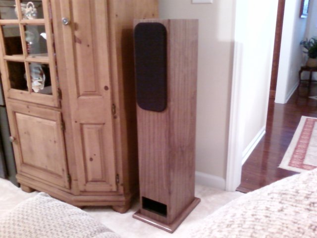

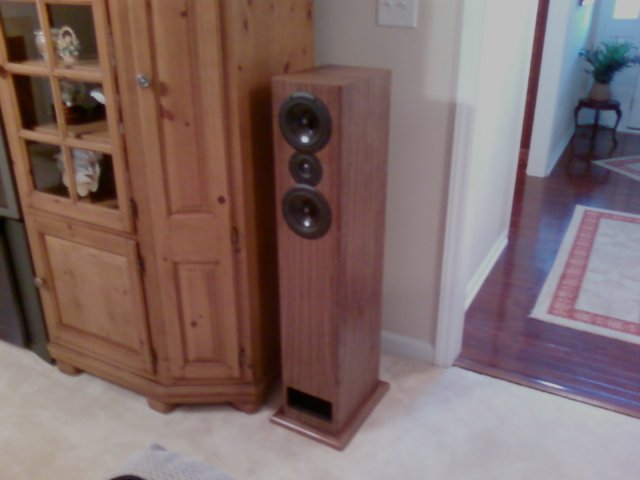

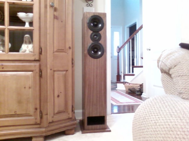

Last summer I posted a few questios about placing the AV3 near the front wall of my living room.  Danny recommend porting to the front instead of the back, eliminate brace C, and it would work.  After searching through the forum, I have found that others have done the same thing but I could not find any pictures of what it would look like.  So, I built them, veneered them in walnut, and they look and sound great. Here are some pics:

Straasha, your  speakers look great. How did you finish the inside of the transmission line?

Before I veneered the enclosure, I taped off the opening and sprayed painted it with gloss black.  The MDF really soaks up the paint so it took about three coats to get it right.

I can't tell from the pictures if the supplied floor spikes are being used or not. Your carpet my be hiding them.
If not, I'd add the floor spikes. It will tighten up the bass response and give you a more solid sound.

I am using the small, black floor spikes that came with the kit.  They go all the way through the carpet and make it appear as if the speakers sit right on the carpet.

« Reply #9 on: 9 Apr 2007, 07:57 pm »
Perfect.

I just noticed that the bases were rounded on the top and corner edges. That makes me suspect the bases are solid. If they are veneered, I'd love to hear about how that is done.

I had several pieces of 1 inch think walnut left over from a hope chest that I had built.  I cut a piece of 3/4" plywood slight smaller than the base of the enclosure.  I then ripped the walnut to 1 1/2" wide and cut/mitered it to go around the plywood.  I attached the pieces to the plywood base using biscuits.  Then simple 1/2" round over bit to get the decorative edge and glued/screwed it in place.
