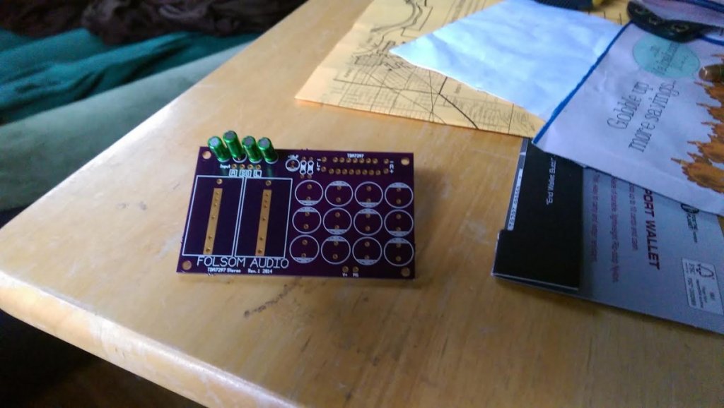

What happens when you put the TDA7297 on them? I've driven Piega Premium 5.2's to moderate levels without issue. They're not efficient.
They do rather nicely for most listening, but just can't do large orchestral pieces with any degree of realism. .  So far, I still need the Moscode HR401.
Folsom
Re: How much power do you really need?? Honestly?
« Reply #105 on: 4 Nov 2014, 04:55 am »
For sure,bass always causes power supply(and transformer)voltage drops,it's not about mids and highs but bass,if you dont have a good regulation transformer, power supply wont recover from bass soon enough to power mids and highs,capacitors actually cause a voltage drop when charging from the transformer so capacitors wont recover the ps charge,it's the transformer that makes a difference here,the bigger the better,what do you think?
A well designed smaller amplifier will stagger capacitors some, so you won't see a drop in the mids/highs. This isn't possible with constant current power supplies to the same degree. I'd argue that you might get a benefit from a few high end caps near the transistor, but I haven't tried it.
Capacitors charge/discharge 90 degrees out of phase. For this reason whatever voltage drop they incur won't matter. Worst case scenario at high volumes the amp doesn't get as loud as the voltage at 120v would predict. Not a surprise, everyone knows amplifiers aren't 100% efficient. The only thing you have to worry about is inrush current from the capacitors being discharged too much. In general no design should be predicting full discharge of a capacitor bank post rectification. If that's happening your amp will sound stupid. SOO in general the inrush shouldn't be that bad.
When to use a really big VA transformer? When you've got a constant current power supply! That's the simple answer. You can use a 330va for a chip amp, but you may never hear the difference between it and a 250va or 160va depending on your capacitor setup.
Look at SMPS supplies, they use itty bitty transformers. Transformers are fit to application. The only reason to stay larger without wanting to meet thermal efficiency for the constant current amplifiers is that if you get too small they generate common mode noise.
