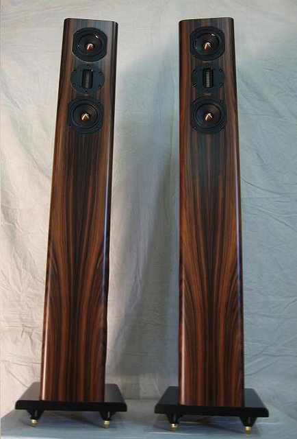

« Reply #14 on: 2 Apr 2007, 07:14 pm »

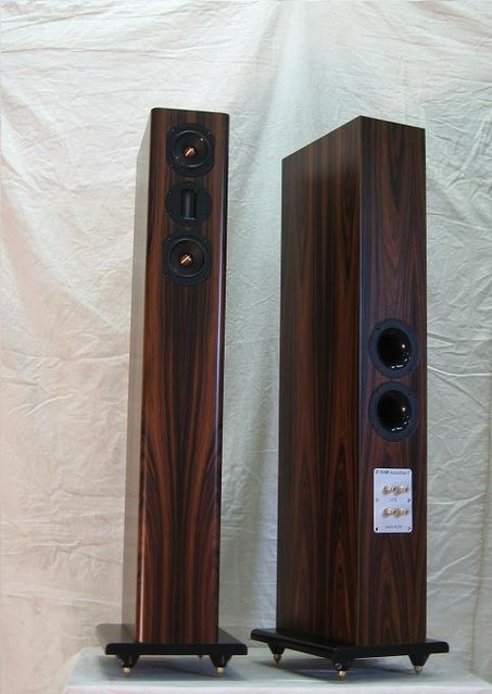

Here are pics of John's completed HT 8's in custom Santos Rosewood.   :thumb:
I'll post pictures taken showing the build process as well.
Cheers
TomS
Re: HT8's On Order
« Reply #15 on: 2 Apr 2007, 07:20 pm »
Wow those are gorgeous!  I love the Santos.  John will be very, very happy.  Tom
Kevin Haskins
Re: HT8's On Order
« Reply #16 on: 2 Apr 2007, 07:31 pm »
Those are awesome.... best looking HT8s I've seen yet.   :thumb:
BlackSandCable
Re: HT8's On Order
« Reply #17 on: 2 Apr 2007, 07:55 pm »
WOW is all I have to say! Is Denny a master with wood or what! Very nice indeed. I was a little concerned as to how the Santos Rosewood would come out but from looking at those pictures they are exactly what I was after and perhaps even a little better.
Very nice work!  :thumb:

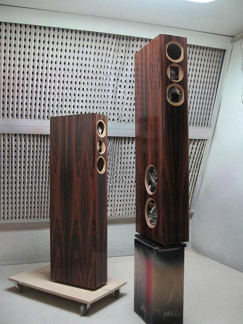

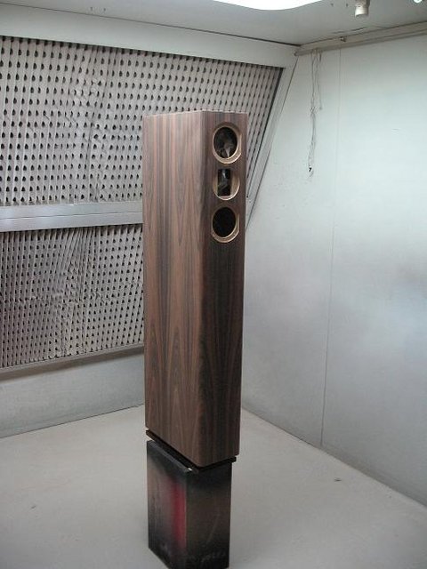

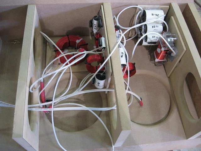

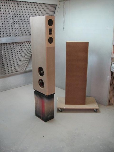

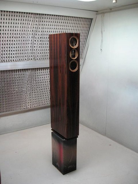

Here are some pics of the build process of John's speakers. John opted for all the extra's on his HT 8's. He's got the full Sonicaps/Sonicap Platinums in the crossover. Al used specific wiring and sent me the crossovers all pre wired. John also opted for the bases with the VB 8 spiked feet. No expense spared.
The crossovers installed.
 The RAW Acoustics CNC baffles are used in the top section and have the magnets in them for the magnetic grill covers. These cabinets feature mitred corners throughout. All brace cutouts are rounded over on both sides for clean airflow and driver cutouts feature roundovers on the backsides to reduce driver loading. The cabinets are sealed with two coats of vinyl sealer prior to veneering, a step many would overlook.
Veneered and sanding complete. Ready for sealer.
Seal. Sand. Seal. Sand.Top coat. Sand. Top coat. Sand. Repeat. Repeat. Repeat. You get the idea....
48 hrs dry time. Then final assembly.
